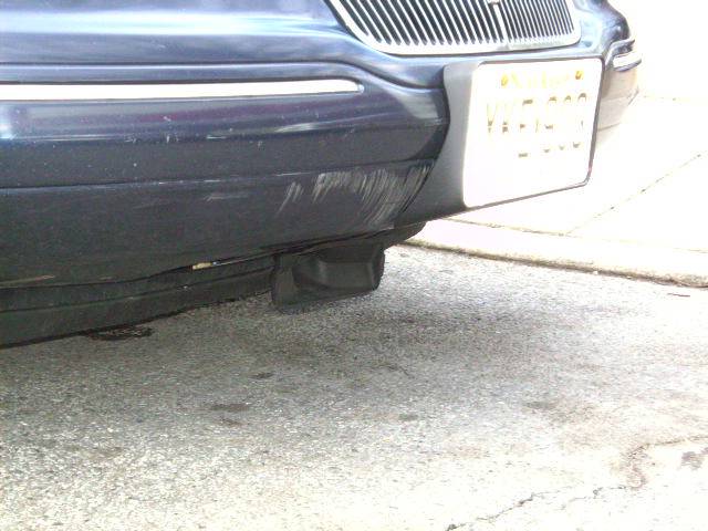

we have K&N's in all 3 marks, my 94 and my bros 95 we have brand new ones in, the other 94 I found a car in that yard with a K&N :) no problems ever, and My 94 I have the air silencers removed and a ram air going in to the bottom of the box
