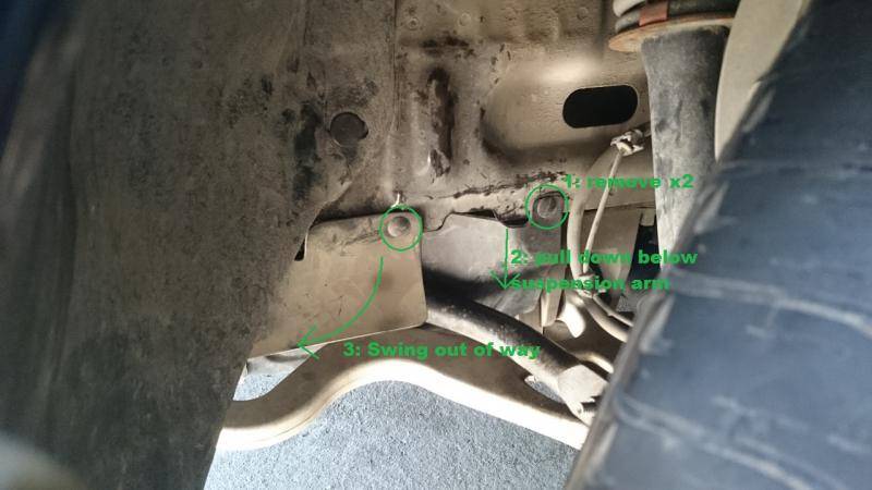

I want to provide better information on how to find the low side charge port, on at least the 03-06 models. I have no idea if this is different on 00-02 models.
I just finished recharging my A/C on my 2006 LS Ultimate (owned since new). I used RedTek products: one can of LeakSeal, one OilCharge, two 6 oz cans of refrigerant. (Note the LeakSeal and OilCharge each have 2 oz of refrigerant in them). I now get about 8 degrees Celcius from the vent at full fan on a hot day. Amazing.
There is NO NEED to remove the fender skirt.
1. Crank the wheels fully left.
2. optionally lift and secure the car (driver side). This makes it much easier to get in there, but if you don't have safe lifting equipment you can still just manage.
3. Refer to first photo below. Remove (pull out) the two circled plastic retainer clips. pull the large cover down below the suspension arm. Swing the small rubber cover (it will swivel on the remaining clip that you didn't remove).

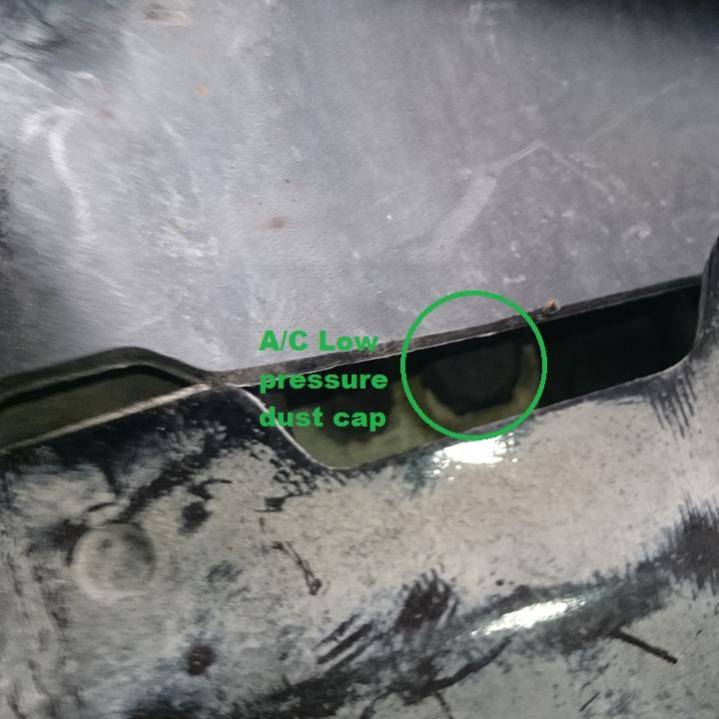

4. Locate the charge port. It is just behind the exposed area, at about the level of the opening, and between the two removed clips. Refer to photo 2.
5. Remove the dust cap. Inspect for signs of oil which would indicate leaking through the port.
