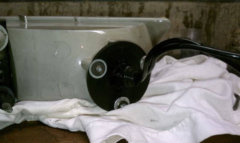

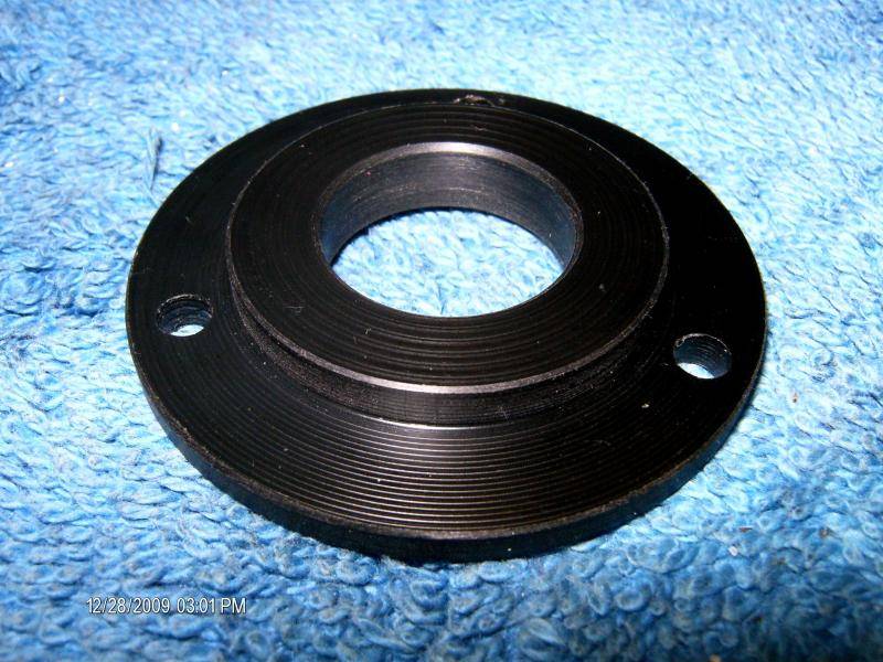

I don't know why you don't want to use silicone, it will seal it better to keep moisture out, once the bulb is in there there's no need to use foam to keep it from moving it will stay in place just fine if you're using DLFs adapters. Heres a pic of what I did, I just put a bead of black silicone around the edge of the adapter and used a generous amount in he center hole around the wires to seal it off.

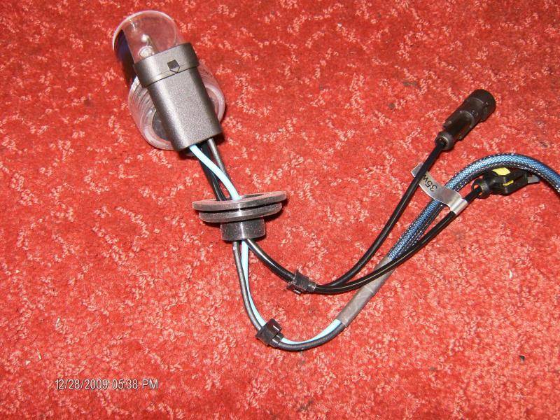

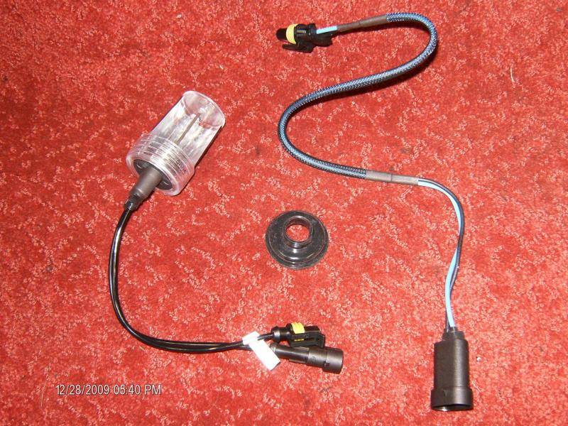

When I do a HID install, I separate the bulb from the power wire as shown in the first two pics.

I cut the rubber surround and then cut out a thin slice to use and act as a seal and to hold the bulb tighter. I had to do it or the bulb wouldn't have been held tightly in place. That's just my experience. The bulb went in first and then I added the thin slice of the round rubber and then the adapter and it all tightened up very snug. Without the rubber being in between the bulb and adapter, the bulbs would have been loose. Wasn't a big deal though. they're in now and sealed fine and held in tight. No worries of vibrations with the bulbs.
One thin slice off of this is what I used in between the bulb and adapter. Worked perfect for me.

On a Gen 1, I cut the rubber washer completely off with a sharp box knife.

With my adapters? I've never heard of anyone needing to shim them. The raised center of my adapters is specifically designed to take up the necessary slack. I've installed quite a few sets and never had an issue like you described. :cool:
