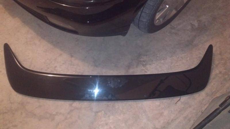

After that I took off my park bench of a spoiler that I just never got around to for almost a year. I attached a photo if you're interested. Can upload more pics upon request.

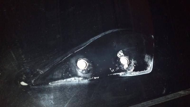

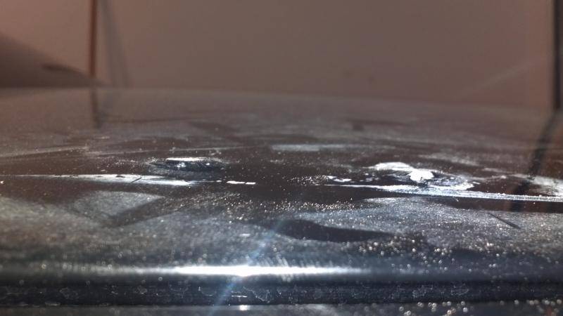

The previous owner did a number on the trunk lid on the install. My buddy said our best bet would be to knock the bevels back down. Then level it back our with a little filler, prep it for paint and have a shop color match it. I know very little about body work. Feel free to give input. For now I have some panel fasteners in the holes to keep most of the water out. Check out the pics also attached.

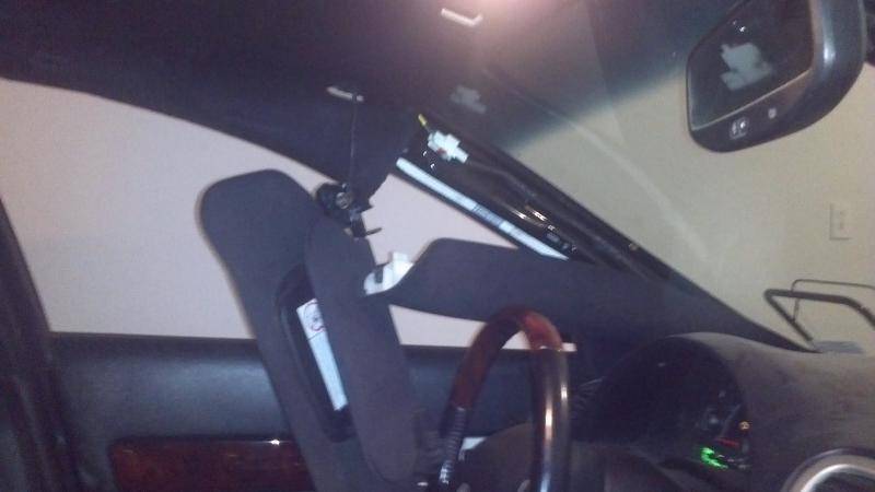

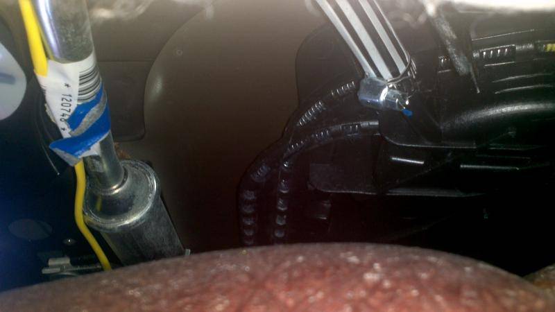

Lastly, I took car of the driver's side sunroof leak. Drain hose was disconnected, I'm sure most of you have dealt with this. For those who haven't I have uploaded a pic of the hose clamp.
