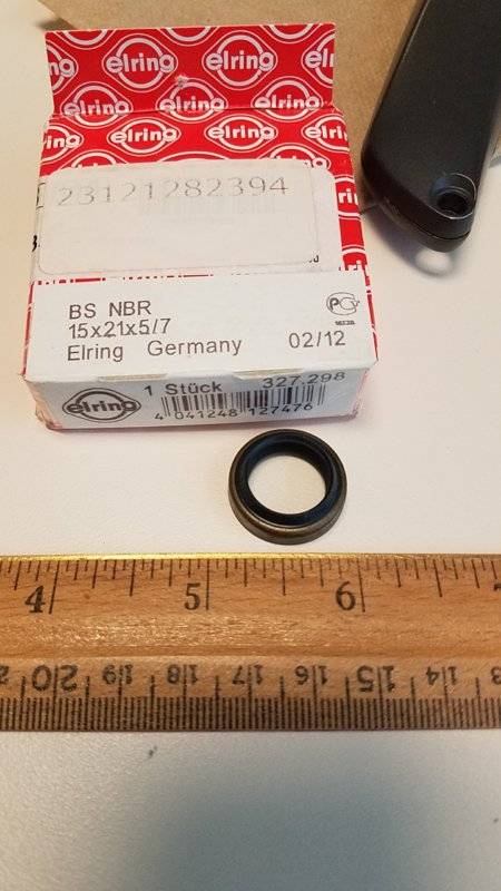

Mine looked like a driveshaft/output shaft seal, but it was really the shift selector rod seal. I changed that output shaft seal maybe 4 times before realizing that it was the shift rod. The way that leaks out, it lands on the spinning shaft and gives you the impression that it is the shaft seal, since the driveshaft yoke spins the oil tangentially, totally incriminating the innocent output shaft seal. I even used the reddi sleeve on the output shaft, to no avail. Here is the link to the new seal for the shift selector shaft: 23121228443 Standard Transmission Shift Linkage Seal - Elring 327.298 (23-12-1-228-443)

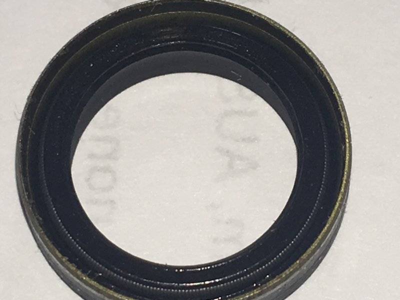

Here is the photo of that seal. It really is small. View attachment 828571582

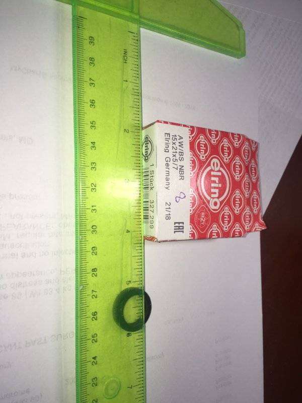

Hey Mikey, man this is aggravating. I ordered and got a part. I'm not sure it's correct. It looks similar to yours but the numbers on box are different. Yours is 327.298 this one is 327.299 There must be 100 of these things. Below is a pic of what I got.
I went to fcpeuro - they dont even list an s-type with a manual trans. I went to terrys jaguar and they have some manual parts but not this one. I''ll finally call local ford dealer on Monday but they usually throw their hands up.
Hey George, that is the correct part. The measurements are identical, as stamped on the box. 15 mm id, 21 mm od and 5/7 thick. Good luck with the repair.. Should be a major blast. Again, expose just the selector shaft and slide the new seal against the old one and drive it in. The old seal will move forward and the new seal should end up where the old seal started from.

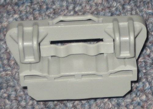

I ended up needing an entire window regulator put it in, works perfect.
