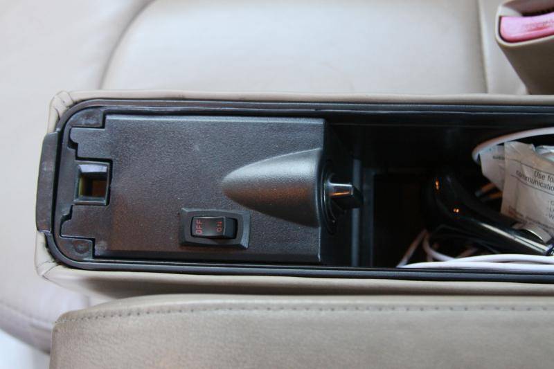

Added suspension shut off switch inside armrest
jerryg2112
Jul 5, 2014
241
45
San Diego
I got tired of being embarrassed after parking my car and coming back to it bottomed out in the rear. It's a pita to keep going in the trunk to shut the thing off so the system doesn't bleed plus opening the door triggers it. I tapped into one of the trunk OFF switch wires and fished it into the arm rest. Still gets me sometimes but overall much better.
