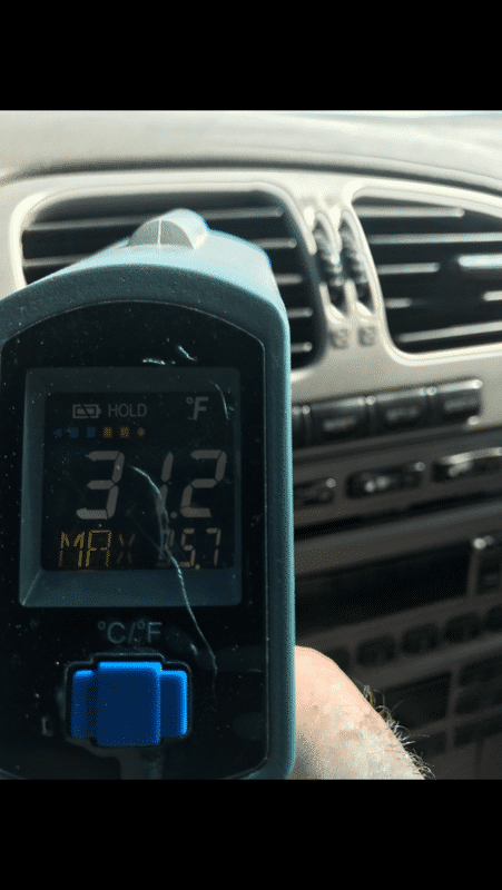

fix the DCCV again but at the same time my ac been shutting off ? Not cycling just goes dead.. when working what little time there is the gauges are reading 70 low / 150 high ..

When ac is working its ice cold ! 32-33F out of the dash
Photo two weeks ago before issues really started acting up
70 on the low side is way too high. There's no way you'd be getting 31 degrees out if the low side was 70.

That's what threw me off was the readings ?
For me the low should be around 25-30 high side 150-200 what reading should I be looking for on this system when I gauge it today the temp was around 116F heat index 120F yeah that freaking hot here in Okla last two days
