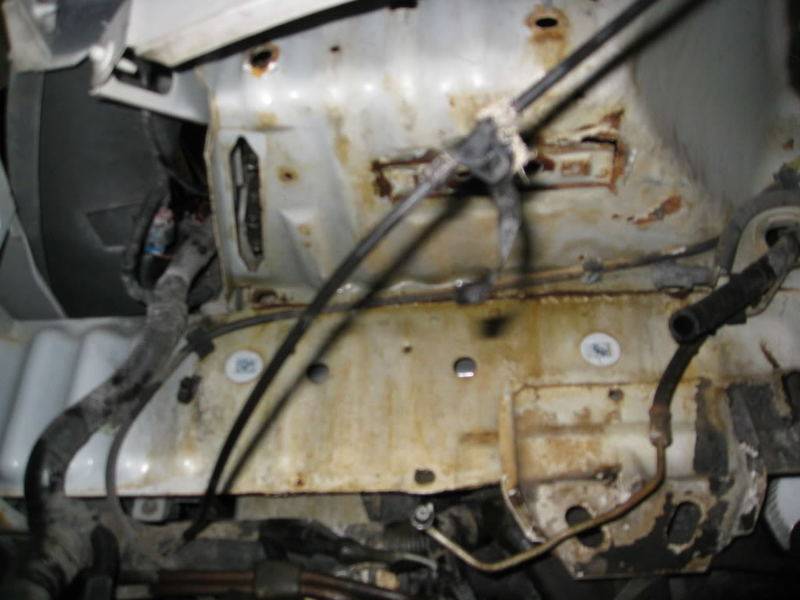

now for an idea of what it looks like and the location.

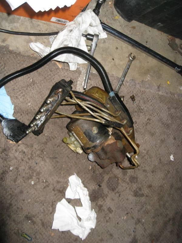

here you can see the pump and valve body.

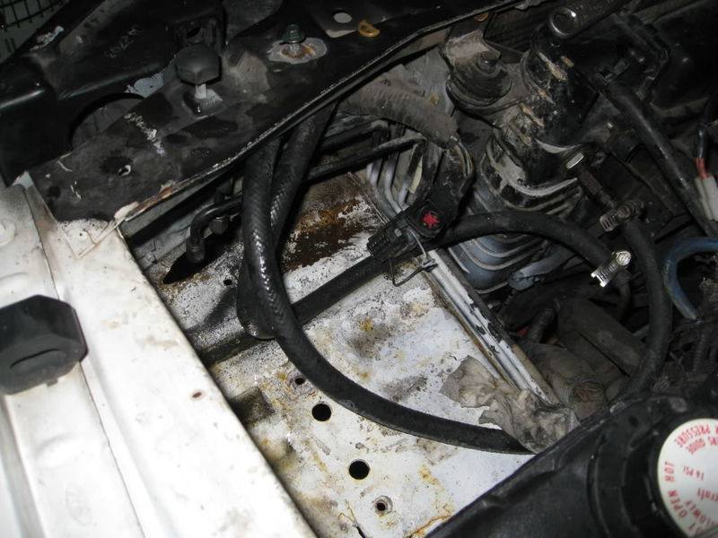

battery and battery tray removed.
directly beneath the battery where the abs pump sets.
