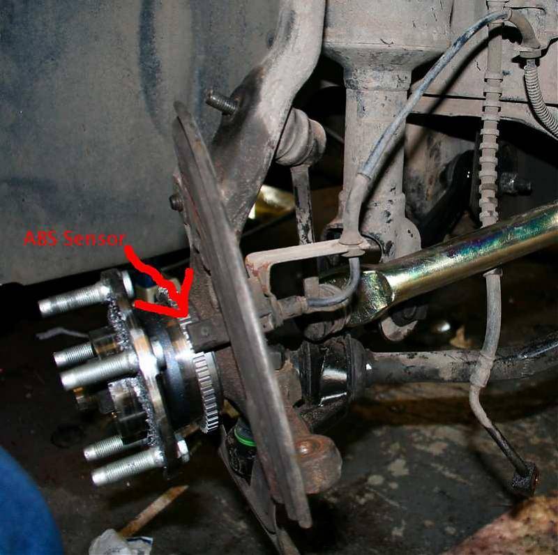

First picture:
Front
You'll see the sensor on the outside (wheel side) of the spindle hovering over a gear looking thing with teeth. ABS sensors work based on magnetic induction pick-up, you really don't want to put any sort of anything on them, as they may not be able to see the teeth on the ring.

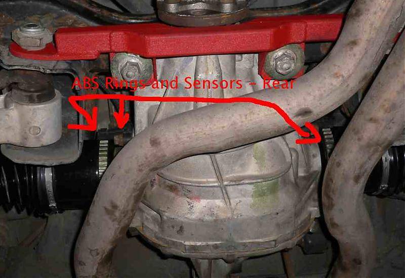

Second Pic - Rear. They are a bit harder to see, but I promise, they are there.

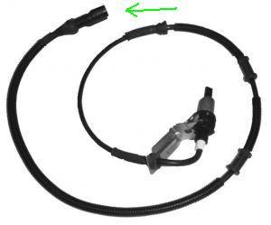

J-miles, maybe I'm wrong, (I haven't had to replace one yet), but aren't those sealed connectors? AKA, you have to replace the whole sensor and harness? Someone chime in here if you've replaced an ABS sensor before.
The sensor comes with a wire attached to it. If moisture is causing a short at the connector, you can dry out the the connector, then fill it with dielectric grease before reconnecting it. The grease will keep moisture from getting to the pins again.
is that a front sensor or a rear? or do all for of them look the same.
I was cleaning out the back ones. they are pretty tricky to get at
