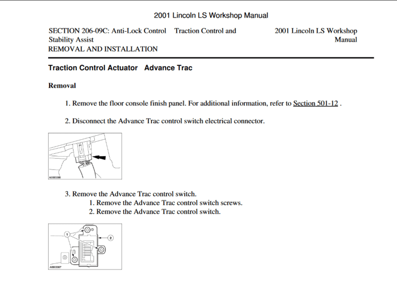

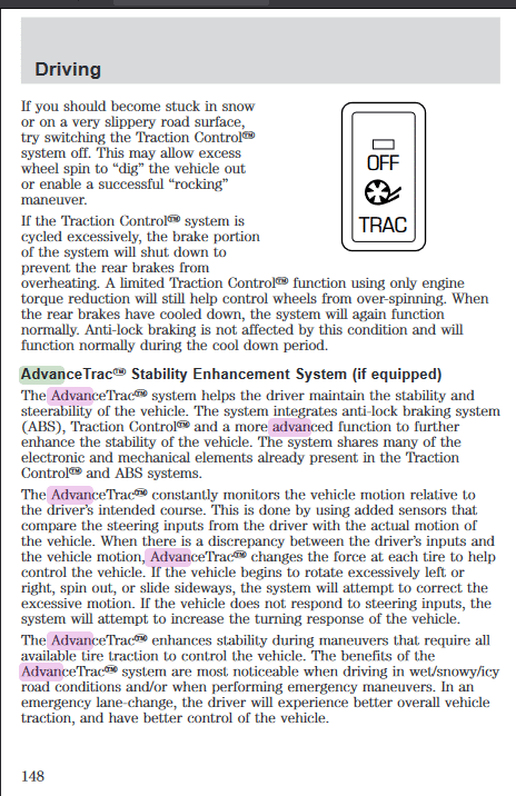

I have a 3.0 and a 3.9 both Gen 1's, and they both have Advance Trac.
Screenshot 2022-01-18 at 11-52-26 2001 Lincoln LS Workshop Manual - 2001-Lincoln-LS pdf.png
Screenshot 2022-01-18 at 11-55-42 T11962LincLSOG-US - 2001LincolnLS-OwnersManual pdf.png

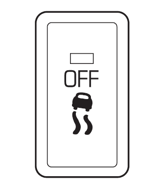

Note that the button image you show is for an LS with traction control, not AdvanceTrac. The AdvanceTrac button has an image of a car with wavy lines behind it. The spinning tire image is for traction control only.
AdvanceTrac has traction control, but it adds stability control to that. In addition to reducing rear wheel spin, it uses the brakes at all four wheels to attempt to keep the car going in the same direction as you are steering.
All LSes had at least traction control. Some also had AdvanceTrac.
