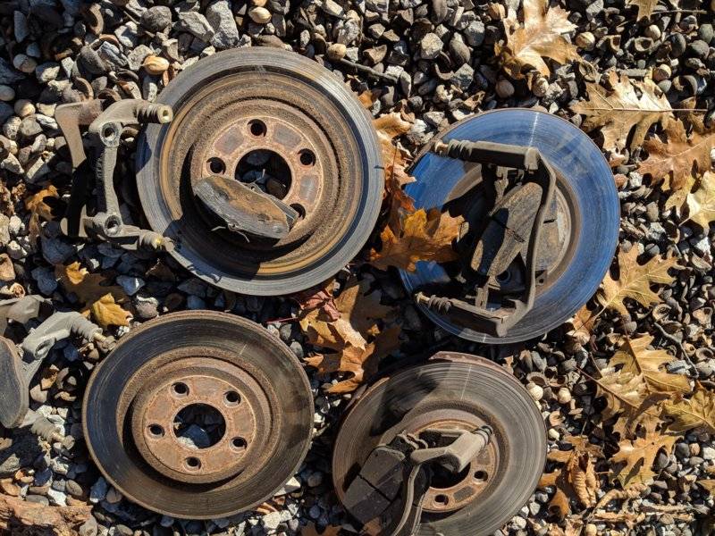

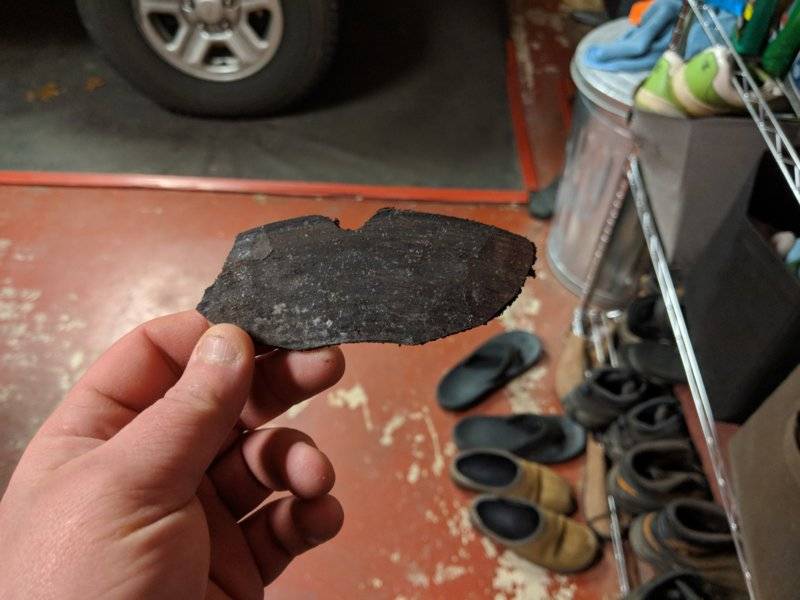

I'll start with the right rear. The pad material fell off the backing plate and found a bunch of metal shavings in the lip of the wheel. Found the pad material in my driveway. Lol

That's a botched brake job on that one rotor & pad.
