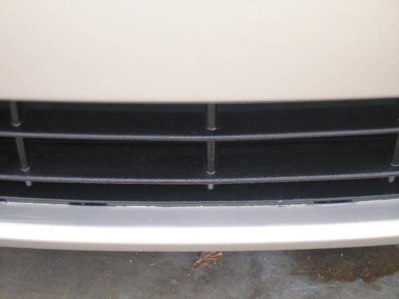

Not necessarily. I used truck bed liner paint (like Rhino Lining) a few months ago. Even with all the I15 construction it has yet to chip. It isn't as smooth as stock (there is a minor texture), but it has held up extremely well!

Here are a few pics. The really close-up is done on the macro setting. I didn't prep the area very well. I was in a hurry and just wanted to see if how well this would look. I also wanted a matte finish.
