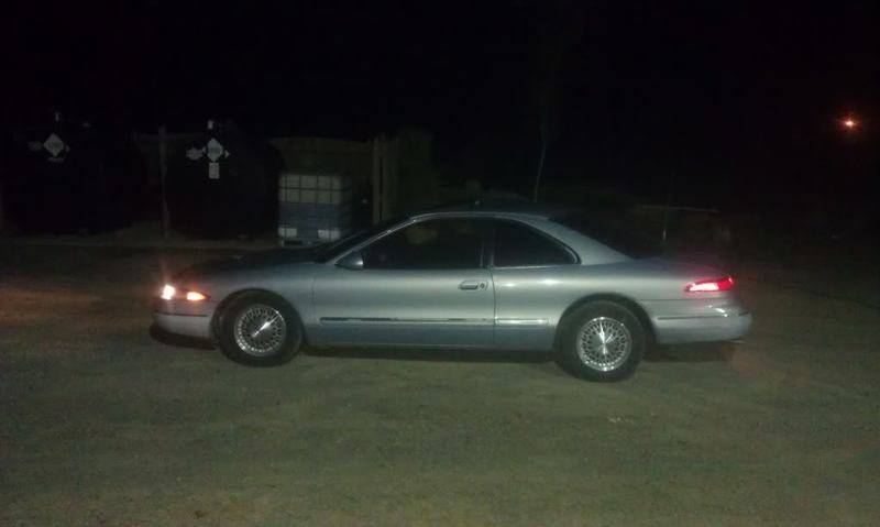

i just went through this
before
after
then i decided to cut a little off the top. i cant find a damn pic with the snow flakes.
That's looking a little high for me Zmt. Like 2" too high. You used the tbirds iirc didn't you?
Just a little too raked for me.

That's good to know. It was hard to re-picture what it look's like back there before I saw ur pic, and I sure as heck aint going outside to take a mental picture when it's 5 degrees out.
Thank's again
2nd pic i posted you can see the shock and sway bar disconnected, the spring in place, and the upper bolt never removed
I saw it then, I didn't have a mental picture before that ;)
