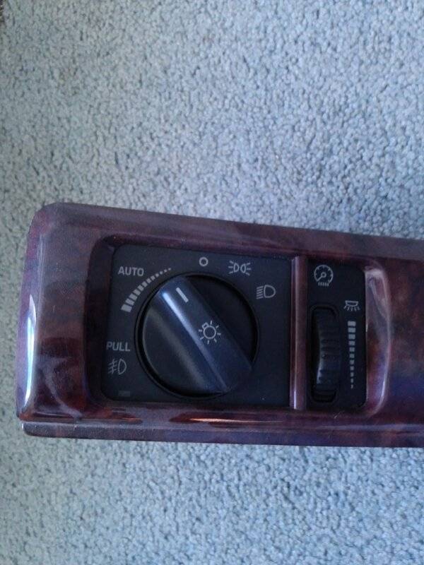

At least some of the Gen 1 light switches have "auto" capability. On my Gen 2 I think you just turn the switch to the left... and when you start the car... the headlights come on.
I say "I think" because I modded my gen 2 switch. Pic of Gen 1 switch below.
My Gen1 does have that switch BUT it only toggles the headlights on in low light conditions.

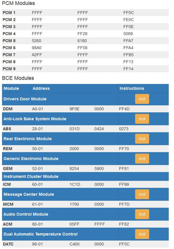

Btw thats a possibility. In fact you can go to here : https://www.motorcraftservice.com/AsBuilt
Enter your vin and then paste as screenshot what you got there. Those are basically the AS BUILT defaults of your car . I will compare with mine and test some changes. Eventually this will solve the DRL and a few other things who knows :) So feel free to paste your AS BUILT defaults here . And its not only for you everyone who sees this please paste the screenshot, this will probably help identify some differences. Meantime here are mine, i think the PCM part is not modifyiable but still.

Ok in this case , can you check my above post and share your AS BUILT settings :)

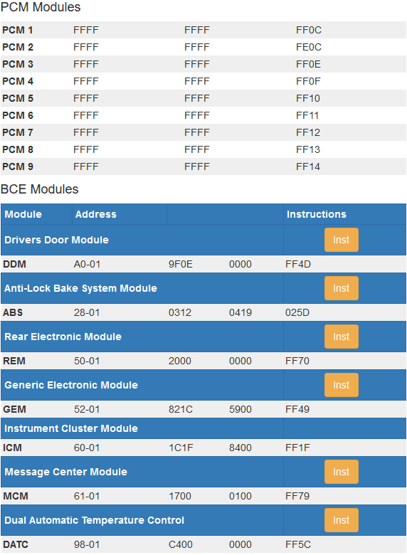

Here's my default data pulled from my VIN (02, non sport V8)
Thank you RyLS, i tested with your settings and the problem is solved, no more automatic headlights. Also its not a DRL i verified and its definitely the headlights turning automatically not the high beams with reduced output. So if anyone wants automatic headlights that are switched on as soon as you put the car into drive and remove the handbrake then my GEM module settings are for you. 8254 5900 FF81 this will enable automatic headlights on your car. Now i am going to experiment with the DDM module i think i should be able to remove the annoying key in car chime somehow from there.
