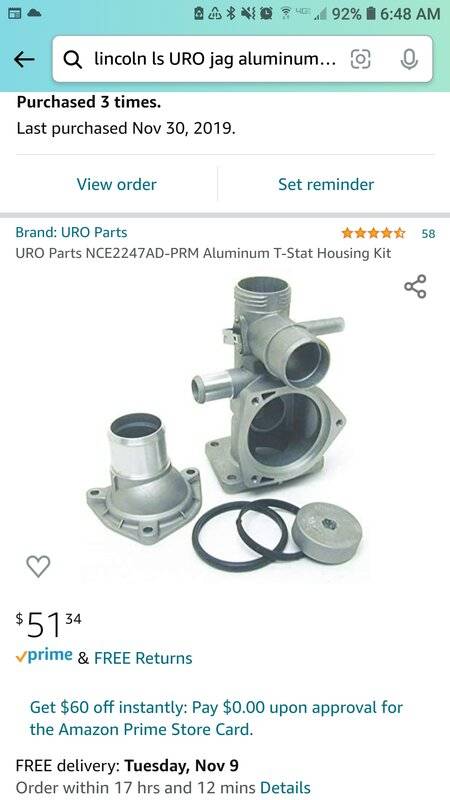

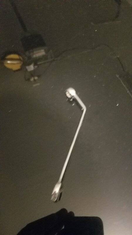

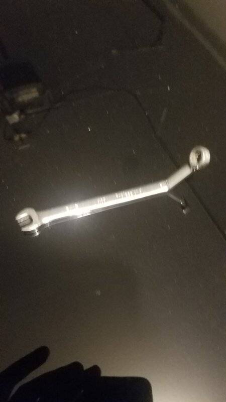

I just bent a 8mm or 5/16 wrench to change out Thermostat housing ...remember to use the URO aluminium Jaguar T-Stat Housing

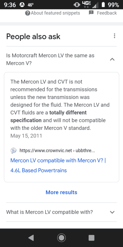

Before anyone starts telling me this is not the right fluid for the gearbox may i say i have enough knowledge on hydraulics and automatic gearboxes , so i know the fluid is not the problem,
Then you should know that Mercron LV is Low Viscosity fluid... and is not to be used in place of Mercron V.
Yes i know it is Low Viscosity , but this is a bit misleading. Mercon V is generally similar to Dexron 3, which is way too thick for my taste , when cold. Mercon LV is similar to Dexron 6 , which is a better fluid. Every manufacturer gives viscosity numbers based on 100C temperature, but in fact the fluid gets a lot hotter, otherwise you dont need to cool it with a radiator that gets up to 100C , in traffic :) so basically the newer fluid is a better product its fully synthetic and in the end , when you compare the viscosity of both fluids under extreme conditions the newer fluid performs better. The newer additives can keep the viscosity at higher temperatures a lot better than the old ones, altho its not mentioned anywhere , because as i said already all the manufacturers give ratings at 100C. Also you can see that even its LV at 100C the difference between Mercon V and Mercon LV is quite small its 7,5 vs 6CST , which is not that much, but this is at 100C ,if the give a spec at 120C they will most likely have pretty much the same CST value and if we go to 150C , then i am positive the newer fluid will have a higher CST value. Altho its unlikely to see the fluid hitting those number except in severe conditions , like 45C outside and pushing the car on some track . Oh and something else, to mention. In the beginning , when they released the 5R55 gearbox some owners have complained about it being too harsh , when engaging gears, so the dealers solved the problem by putting viscousity modifier in the oil. Basically they were making the oil thinner to solve the harshness problem.
This is false. The truth is that during the 2003 to 2004 model years... the Ford tranny fluid supplier forgot to put a certain chemical in the transmission fluid.
Ford issued a Technical Service Bulletin for customers that were having shifting issues and slippage/harshness.
Anyone who came into a dealership complaining about transmission problems... the dealer installed the additive.
There were some LS's during that time... that fell through the cracks... and didn't get the additive.
There are a couple members on this forum that had to deal with that... by rebuilding the transmissions between 50-75 thousand miles.
Does the Motorcraft Mercron LV bottle say it's compatible with Mercron V ?
No it doesn't. Use the LV at your own risk.
