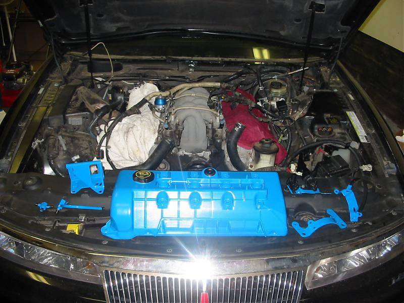

how hard is it to get the valve covers off these cars ive tried and i cant do it, the valve cover gets pinched between the strut tower and the cam gear i really need one side off to replace the gasket cuz it got pinched somehow and now leaks oil onto the manifold...

You can get the valve covers off I've done it. The drivers side gets tight against the brake lines going into the master cylinder but with the right angle and a firm tug it comes out.
