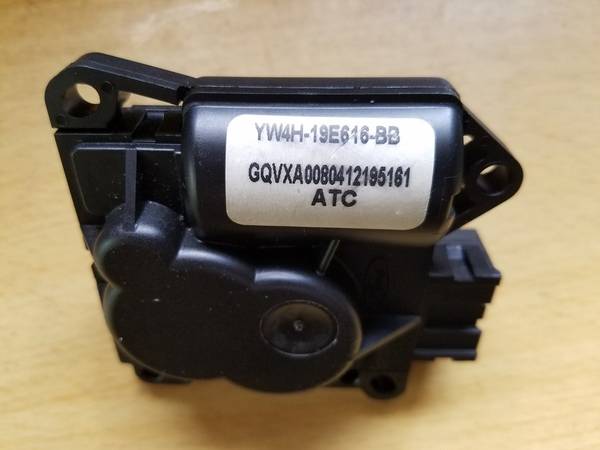

Original motor I removed from the car.

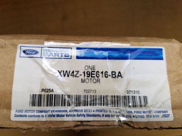

I got this first from Rockauto. Part # on the box.

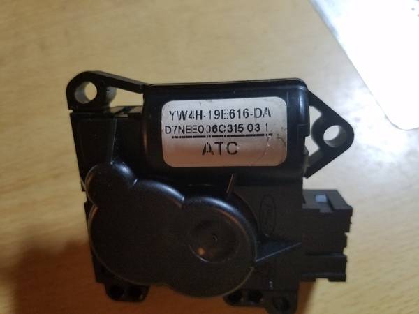

Actual motor that was in the box ( I took this picture after I installed it into the car and remove it to replaced with the BB motor I got).

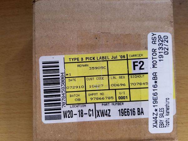

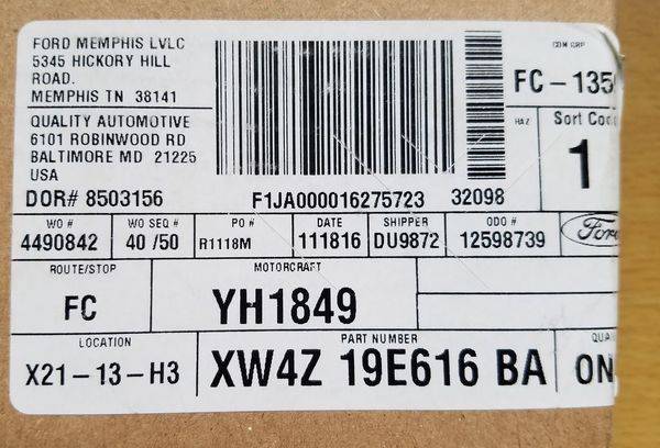

Second motor I Order. This time it's from Tasca.
This is how I received the part. Box was open an was taped closed. Something fishy..........

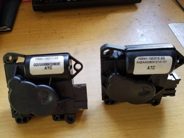

New motor I got from Tasca is on the right, old one I removed from the car is on the left. Notice that number on second line is different.
Notice that both box has XW4Z, but all the motor, including the original motor I remove have YW4H? What are we paying for?...............XW4Z sticker are so expensive......................
