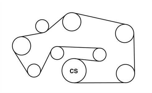

This is all I've found as far as a belt diagram.

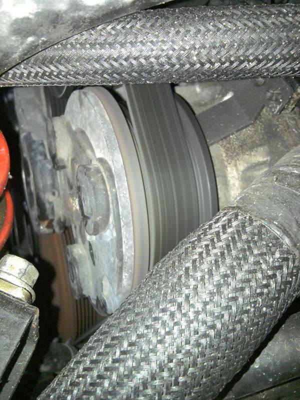

Now from the looks of it I'm assuming the lowest pulley on the right side is the A/C unit. Heres a picture of mine (assuming this is the A/C)
Now from this angle its hard to tell but it was running when I took the picture with the A/C on. IF what I read is correct shouldn't the inner part of this pulley (little nut looking deal) be spinning when the A/C is turned on? Basically the clutch in there is not connecting to even turn the system on? Am I on the right path?

The place to start is to look at the AC compressor clutch. When you turn the AC on (engine running) the center part of the clutch should spin with the outer part. When you turn it off, it should stop.
If it cycle on and off a lot, then it's probably low on refrigerant. If it doesn't come on at all, maybe they disconnected something. I know that on gen II there is no reason to mess with anything AC related when changing the coils. I don't know about gen I.

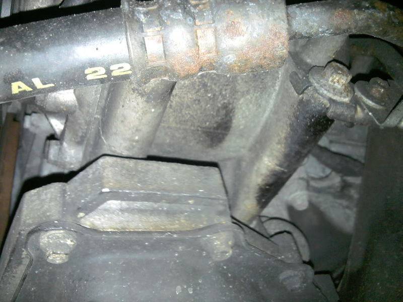

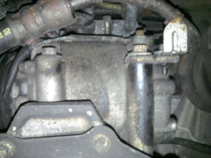

Look on the under side of the AC compressor. If it's oily, a common leak point is where the two halves of the compressor join. (Oily indicates that it's leaking.)
I couldn't see the connectors but I'll do more searching later. The car does have a full Zeibart underbody coating and iodized treatment. Just by feeling the residue on the bottom of the compressor it didn't feel like oil but it could be mixed in with what looks like overspray to me.
Heres some pictures I just took after you recommended I check out the underside of the compressor.
Not to sound like an arse, but we all over look some real basic stuff some times. You did check all of the fuses first right?
Yeah I did check all the fuses. Thanks tho sometimes it is just the little things. I'm hoping this is an easy solution :crosses fingers!:
Yeah, I don't see any signs that it leaked at the compressor. That's good news.
