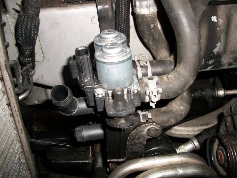

also does it mean i need a new dccv if the passenger side sometimes does the opposite of what my driver side is doing? my ddriver side always is correct , but once in a while the passenger side acts up

must have leak , it was recharged a day after i bought it in mid january, if i physically look at the DCCV can i tell if it broken or something?
No the DCCV is a set of solenoids and the problems would be within
