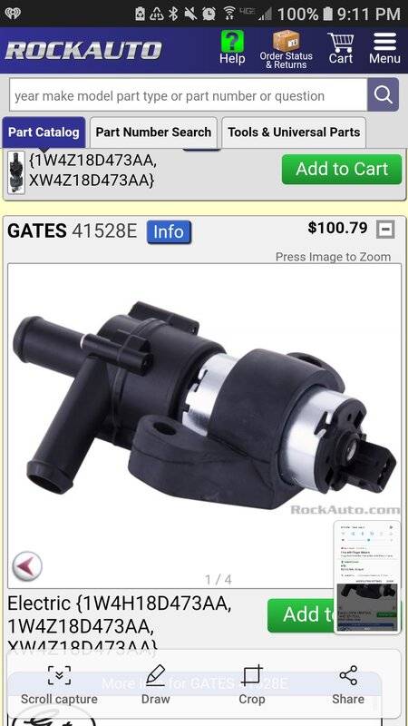

I would start with a Auxiliary coolant pump and DCCV...both get gummed up after 10+ years ...when I changed my DCCV last fall I thought what the hell, may as well change the Auxiliary coolant pump since I'm in here ...thank God I did it was so crusty and gummed up from years of heat and what not...almost sandy even ...anyway disregard this post of both are new...as far as brand I went with Gates Auxiliary coolant pump and MotorCraft DCCV
I am confused about the aux pump. A failed aux pump could only make it cooler, not warmer.
