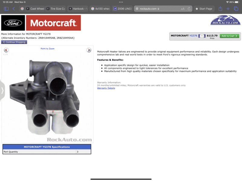

It's all here in the forums. You'll be the DCCV like everyone else. Don't get the aftermarket one.
The codes and troubleshooting are here: 2006 Lincoln LS Workshop Manual
This is the DCCV, right?
