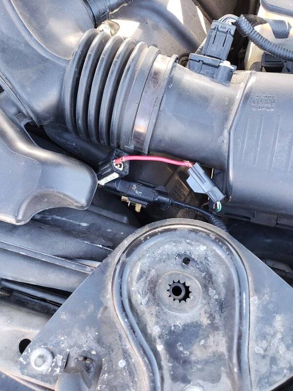

Fan update, runs full speed if you plug scanner in and tell it too, but it runs slower than computer demands, and fluctuates from demand and actual speed somewhat randomly. I gotta find that other thread again and hotwire it like you told me until I can get a new one, gonna be 90 this week! Thanks.
... I gotta find that other thread again and hotwire it like you told me until I can get a new one, gonna be 90 this week! Thanks.
Cut the White/black wire going to the fan and it will run full speed the whole time the ignition is on.
You will be treating the symptom instead of the problem. The result is that you will wear your fan and your alternator out pretty quickly, while the coolant flow problem remains.
Your test shows (as very likely) that the fan is okay, the wiring to it is okay, and the PCM fan control is okay.

Works good now, thanks! Need to run a toggle switch inside them I'm golden, ha!
