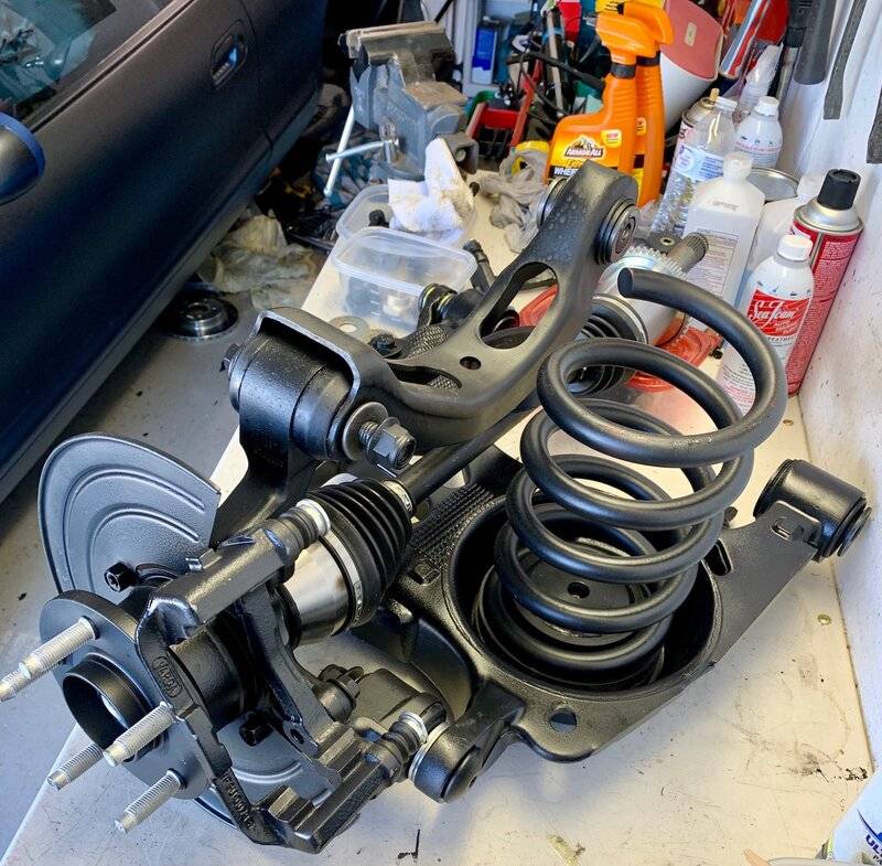

This is what the rear end of my Mark VIII looks like...
The Hub and bearing are pressed together with the knuckle in the middle as a unit.

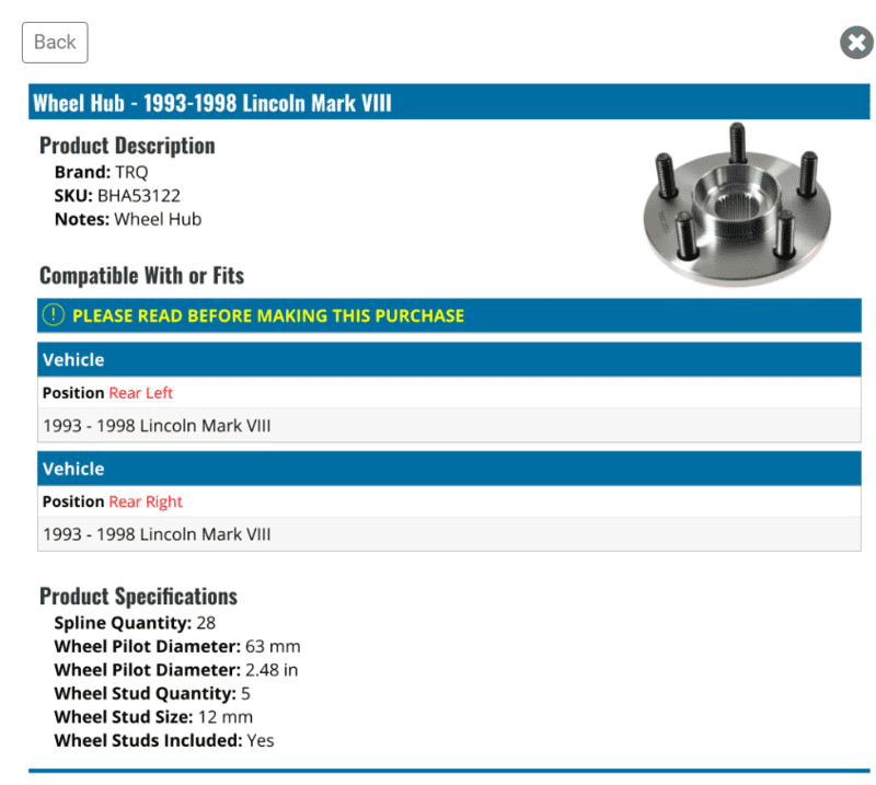

Hub listed on Partsgeek, don't see any on RA.

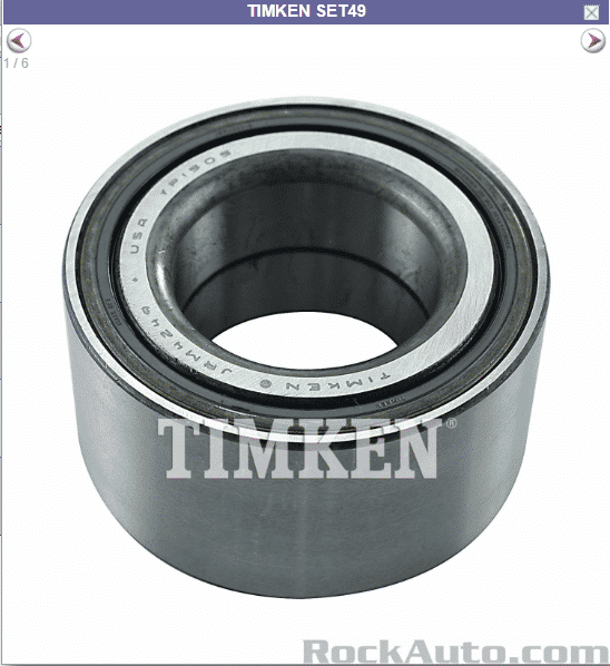

More better bearing on RA.
