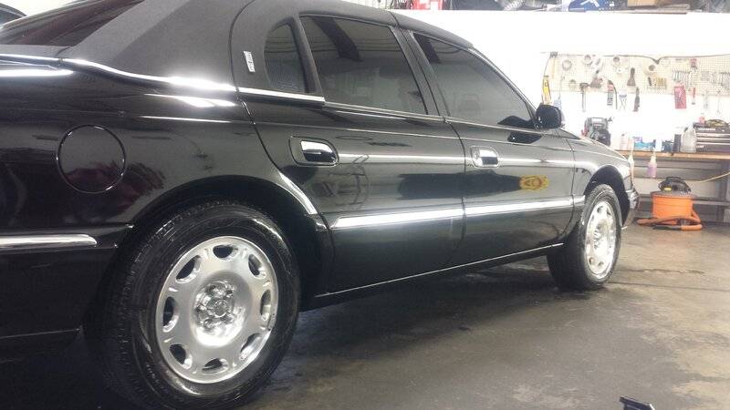

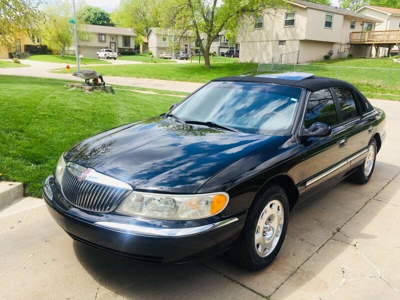

Dude your car is beautiful!! Keep up with it.
Myself and FlaOkie keep our cars on Deltran Battery Tenders when the cars are sitting. Might want to look at one of these to keep it on. Especially if your mechanic says the battery voltage drops.
Looks sinister with the windows tinted. :cool:
Thanks, I’ve owned the car nearly 10 years. 113k all original car one owner. Garage kept. She’s a cream puff
