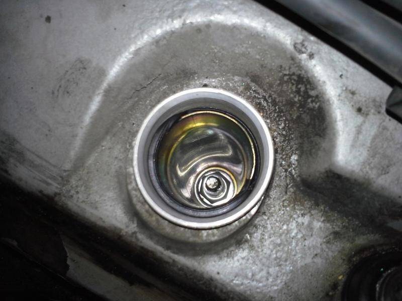

        In my experience, Oil in the spark plug-wells is usually an indication that the tube-seals have expanded or contracted beyond their OE specification which will then allow oil to seep in. When you change the plugs, or have time & feel inclined, take a look at the top of the plug-wells to see if you notice any grey or black seals being offset(slightly exposed into the tube or pushed in) where the valve covers meet the wells.
        Random pic with bad tube seal, notice the black grommet is not symetrical.
        This is usually remedied by purchasing a new set of valve cover gaskets($30-50 Rockauto FEL-PRO*, a bit more at local vendor) which they often come with 8 new tube-seals.
