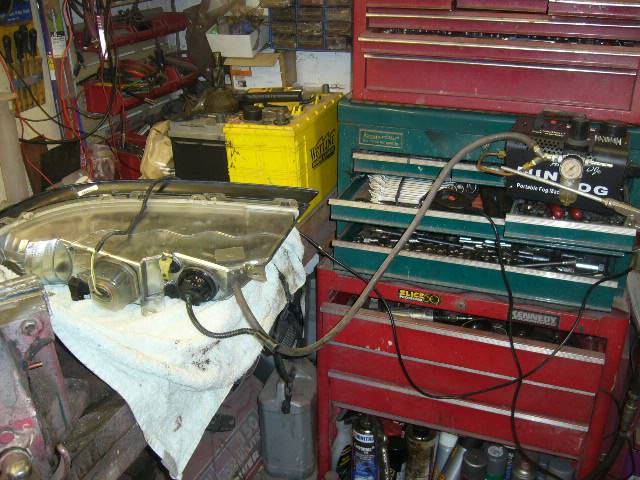

Got fed up of pass headlight fogging up and producing condensation, and couldn't find the leak, so I smoke tested it.
Heres a link to youtube of the smoke pouring out of the join where the lens is glued. Amazed the hell out of me!
smoking mark 8 headlight - YouTube
Duct taped it up temporarily and fogging not reappeared.
So, its off with the lens and I'm going bi xenon.
Andy.

hi J.
What did you use to stick the lens back on? If mine looks half as good as yours, I'll be happy.
Andy.
I used butyl tape for windshields, just rolled it till it fit the channel.
It's not really tape but that's what they call it.
