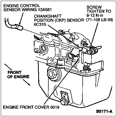

Any guides to replacing CKP or connector? Should I go ahead and replace both (nolt expensive) while I am there? My chiltons is terrible and doesn't show the location of the sensor on a conti, only on a TC where the engine isn't turned the same way.
I tried to show you the pic from the service manual.
