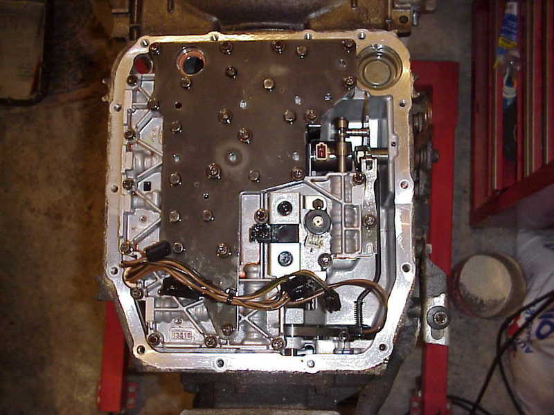

I've got the trans on the stand, pan off, and draining fluid. Looks nice and clean in the pan and case. Going to check all solenoids with Volt/Ohm meter to make sure their good to go then tear it apart.

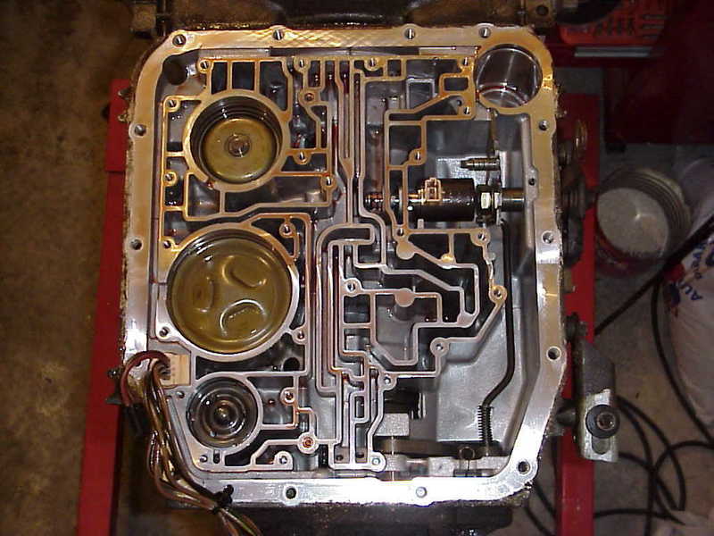

Project is moving along. Got the main control off and apart. Going to drill it out today, put in upgraded parts, and get it back together.

Here are a couple pics of the progress.
