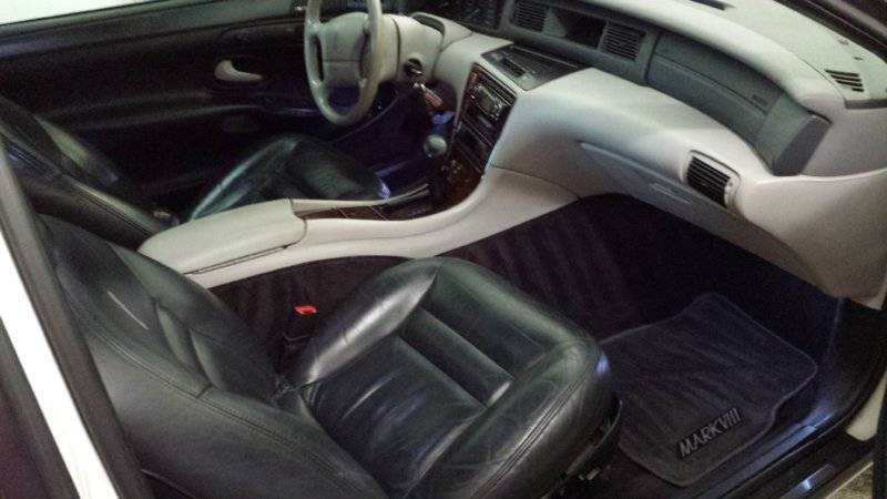

As for the 97-98, they do have a cleaner looking engine bay since there are no plug wires. Also, the IAC is much much more accessible on a Gen 2, and the TPS. Some say Gen 2 interior is more comfortable than Gen 1 but I don't have any complaints with comfort. I took the black out of my 94 and put it into the 95, but left the graphite dash and console. Good luck on whatever you choose.
Hello "Nolimit95," your interior is sick!! Beautiful job with your color choices. Do you have any exterior photo's of your 95 Mark VIII? BTW, I am still riding on air also, I love the ride that the air struts provide. Once drove a 97 with the coil spring conversion, the ride was fine, but I prefer air. Once again, beautiful interior!!

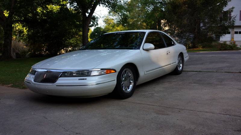

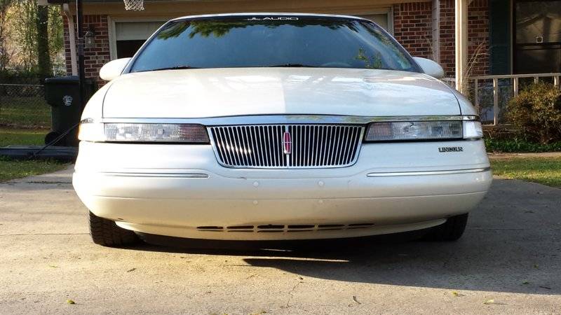

Thank you both! I do have exterior pics. My son (17) takes them all the time. Some other things I had bought for it before they sold out were headlight housings, side-parking light housings and a new grille. Most of it came from Tasca Parts
Damn! I am so jealous! You have the Octastar wheels! Totally sick!! Beautiful Mark VIII!! Did you replace the rear window seal? No waffling.
