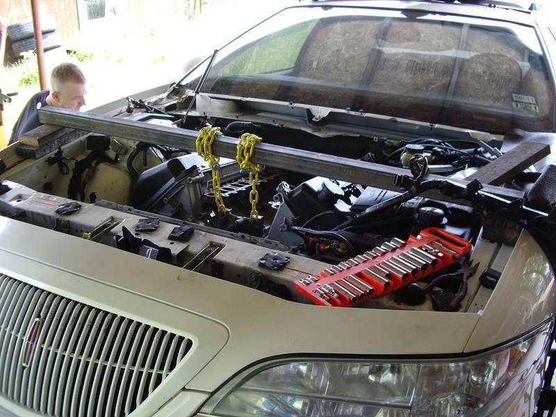

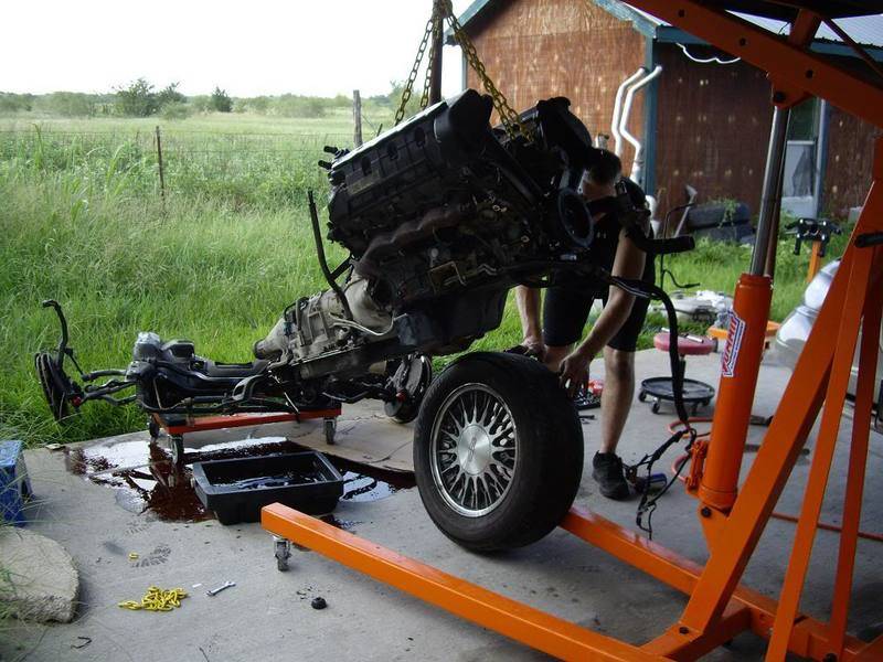

Disconnect so chit up top and brace the motor.
Lift the nose up and unbolt stuff on bottom.
Set car back down with engine trolly under k-member.
Lift car back up with engine hoist.
Slide drivetrain out then pose for stupid pic.
Divorce trans and lift motor.
Reinstall in reverse order.

I pulled my engine/trans out the top. Was very easy to do. Have to remove A LOT of stuff. But if you hit it hard it will not take long. I think the preferred method is pictured above. Taking it out at the bottom via disconnecting the k-member is probably the easiest.
