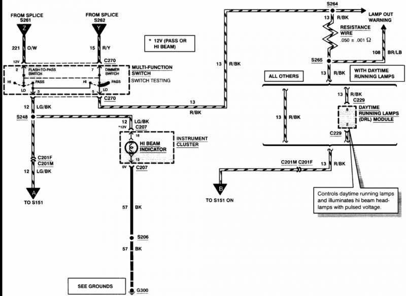

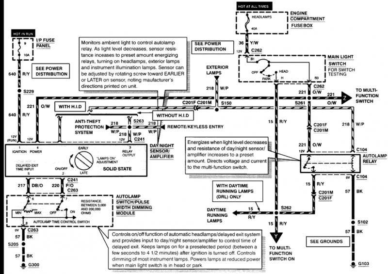

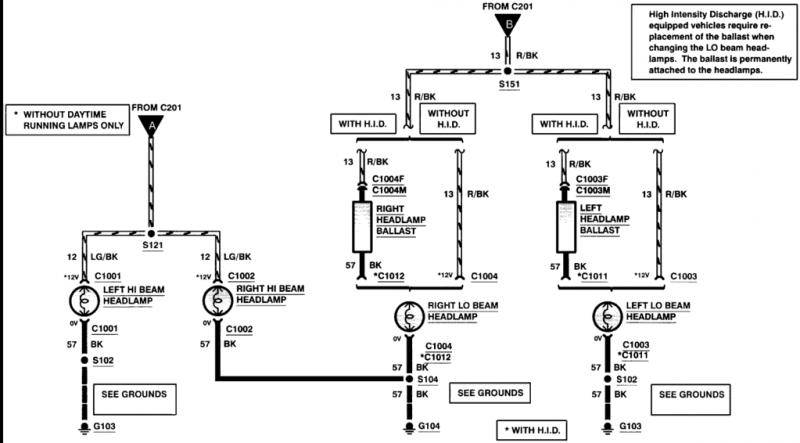

Here are some wiring diagrams from a 95 (you do not have HIDs') but should still be the same.
thankyou for the replies and schematics..removed dimmer and auto on switches,problem persists..must be master headlight switch or autolamp relay? is this the relay under hood? removed main switch,cleaned and blew out,re installed(with dimmer/auto on still removed),relay under hood clicked a few times then lights stayed on again..changed relay,problem persists
