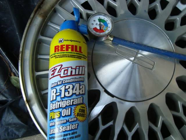

If all fuses are good and your cooling fan IS coming on when you turn on the air, go get two cans of what you see in the pic below. One can with a gauge and one without. The line and gauge can be moved from the empty can to the full can. Both cans will be right at $40 and it works. O'Reilly's and Wal Mart has it.
If there is no pressure in your system, the compressor will not engage. Once the pressure starts to build, it will come on and off. Add a little at a time. When the compressor kicks on, press the button to add more and finally, the compressor will stay on. If it's out completely, you will be getting into the 2nd can.
