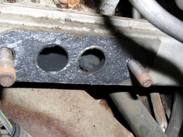

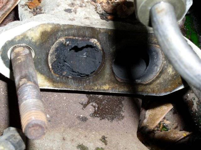

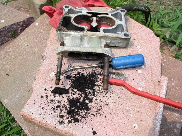

Not yet ... but I still sugest cleaning everything related to the EHAUST GAS RECIRCULATING System.

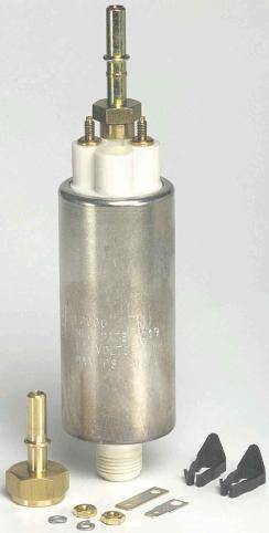

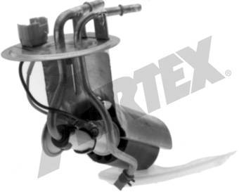

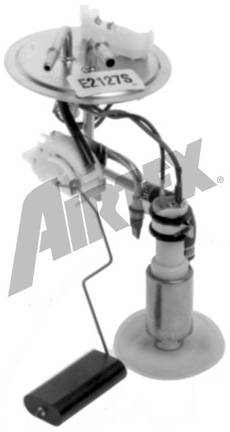

Fuel Pumps
Just for information purposes
top two are 84 CFI low and high pressure fuel pump
bottom is regular FI fuel pump:) (found at rockauto.com)
I've grown so accustomed to looking for parts in the yards that I sometimes completely forget to do parts searches online.
Low pressure in the tank and a HIGH pressure, frame mounted pump under the rear passenger's window. Thank you VERY much for the knowledge 8494.
