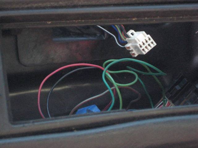

Does anyone know what or where does this 7 wire connector go or connect to? I have looked all over and remove the dash from the firewall to see if I missed something but there's nothing there. Please Help

Here are some shots of the two radio harness and the unknown harness. This thing is driving me crazy, I have been seaching for days with no luck.

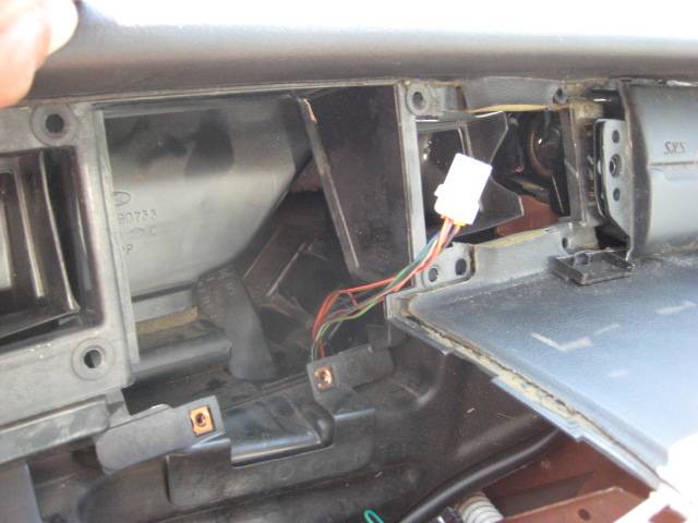

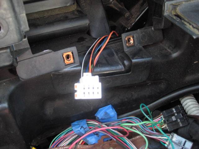

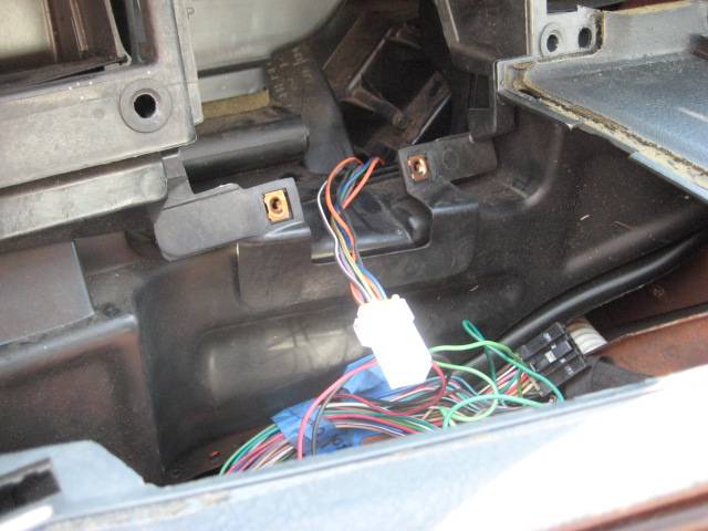

Blend door acturator approaches, but the connector is black according to service manual. Maybe the tstarter can write down the wire colors here to determine more accurate?
Blend door acturator is on blower module, behind glove box, nearer to the center of the IP.
uhhhhhh im not sure id guess 3, temp, direction, and recirculation. might just be 2 recirc could be vac. but i know that connector and its a actuator
theres the temp blend door thats a pia and its behind the radio
the directional one is usually down near the gas pedal on the side of the box
id bet temp

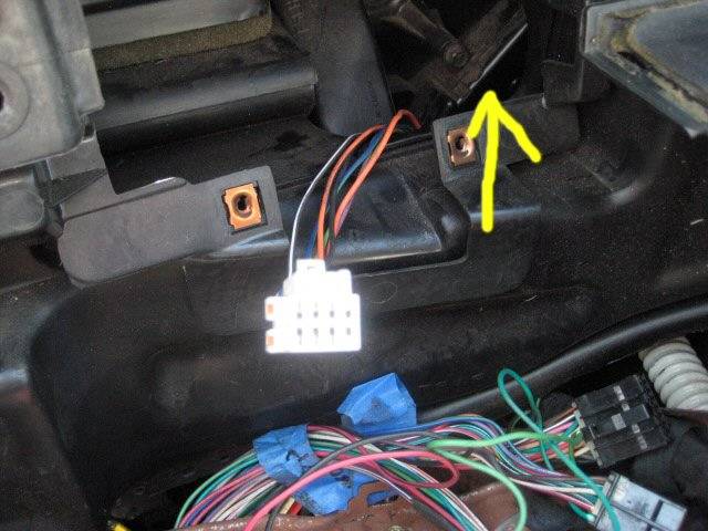

:super ninja edit: that looks like the actuator here
Chicken you the man... There's a steak meal waiting for you if you are ever in Atlanta.
