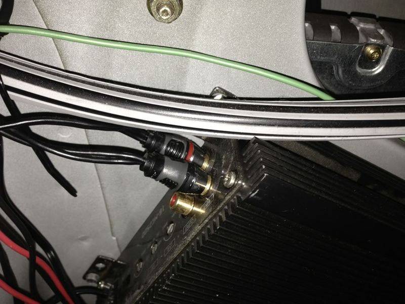

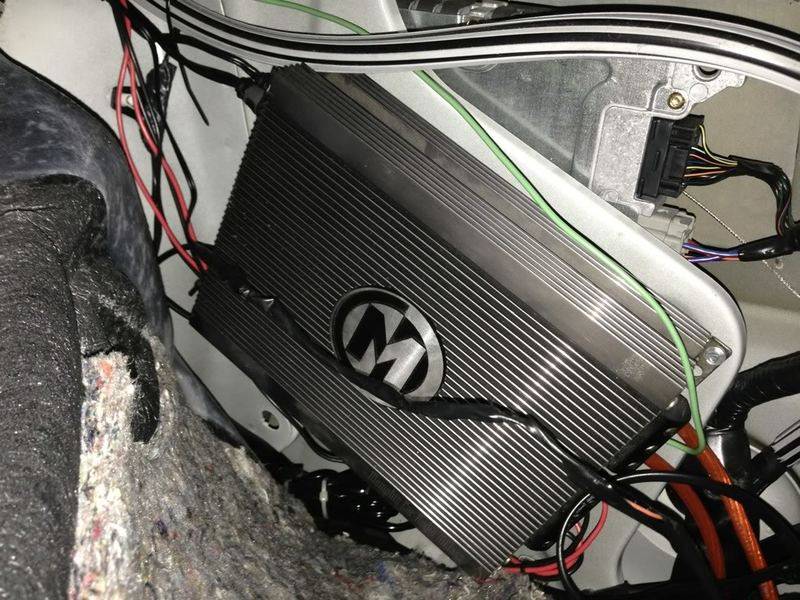

You could of wired it up without having to buy a new headunit. The factory amp is garbage so I ditched it for a Memphis amp I had laying around.
I bought these: http://www.crutchfield.com/p_136XDCLR2S/JL-Audio-XD-CLRAIC2-SW.html?tp=2802
...and spliced into the factory speaker output wires that plugged into the old factory amp. It runs those factory speakers fine but you're better off getting an aftermarket sub with box. Regardless the new headunit should have RCA outputs for your sub amp so you'd just have to run new wires from the dash to the rear.
