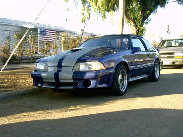

my ex totalled my 89gt the day my SC came for it. I was putting 397 to the ground with lowered compression. The wifey took her out for some quick errands. I got the packaged in the mail, and called her. "be right there" she says. Ten minuted later "ummm your gonna hate me" When I went to the accident in her POS focus..... I saw my car I saw her, then kept on driving. she found her own way home that night. And thats why I am now divorced.
I didn't let her drive the car, She kinda found the keys and took the car without my knowledge or permission. Thay's why she is an Ex and the fact that when the cops called me about the car I told them she stole it. I do have some pics around of it, I just got put them up on here.
