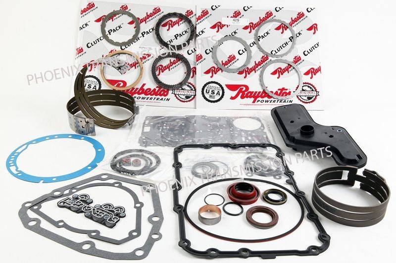

I'm plannaing to rebuild the transmission so I'll buy the rebuild kit and a transgo shift kit.
I'm not sure Which rebuild kit should I buy ,
These are my options :
http://www.ebay.com/itm/351146017531
http://www.ebay.com/itm/8075008294
I just can see :
kit "1" include reverse band / less bushing kit
kit "2" no reverse band / includes bushing kit
any tip ?
thank you!

If you're going to go to the trouble to rebuild it, I'd replace all wear parts so I'd suggest kit 2, then ask about the missing bushing kit and reverse band.

I bought the kit#2 and the transgo shift kit.

5R55N LINCOLN LS Auto Transmission SUPER MASTER REBUILD KIT w/ solenoid.

I'd opt for the most complete kit with as many wear items as possible, then purchase what wasn't included separately. My preference would be for a complete kit, but if not available...
