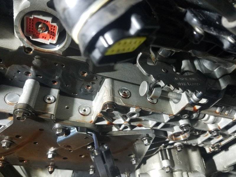

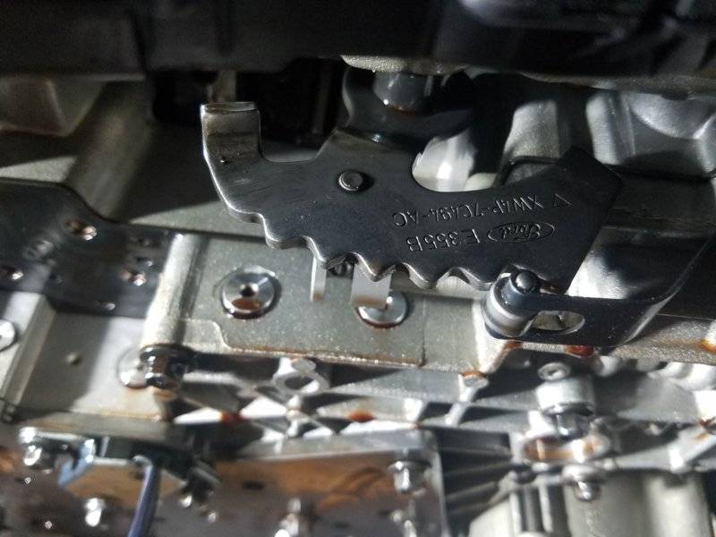

    Hey 04' just wanna say you've been such a great help thus far and want to say I appreciate you walking me through this solenoid replacement ...next question I have is......How do I know where this pin or rod should be on the tooth the shift cable is connected to? If you don't know what I'm talking about just ask... 20191014_190525.jpg 20191014_190502.jpg
    It's the part with the writing on it

    Don't know the technical name... but I'll call it the gear selector detent arm, (or detent pawl). It should be attached to a shaft that goes through the tranny case... outside to where the shift cable attaches to another arm.
    As long as you haven't moved the external arm... the shift cable should re-attach with no issues, as it should be in park now. Rotating that 2 notches would be in neutral... like the video I showed you for adjusting the DTR.
    If when you go to attach the shift cable... it doesn't line up with the ball in the external arm... there is an adjustment procedure for that.

    Doesn't anyone know which teeth/sections on the Gear Selecter Detent Arm represent which gear? P, R, N D5, D4....ect...ect....?

    Remount your shifter cable bracket to the trans... but don't connect it to the external arm.
    Then hop in the car and put it in park. If the trans is in park... the socket on the end of the cable will line up with the ball/pin on the external shifter arm.
    If it's not even close... then move the arm on the side of the transmission until everything lines up. By the pic... it looks like it's in park.
    Either way... you can get it to line up at some point. The cable is fixed at both ends. The shifter above... and the bracket below.

          I found out what the part is called ...5r55n Transmission Shift Linkage Detent Rooster Comb ...WOW! That's quite a name lol
