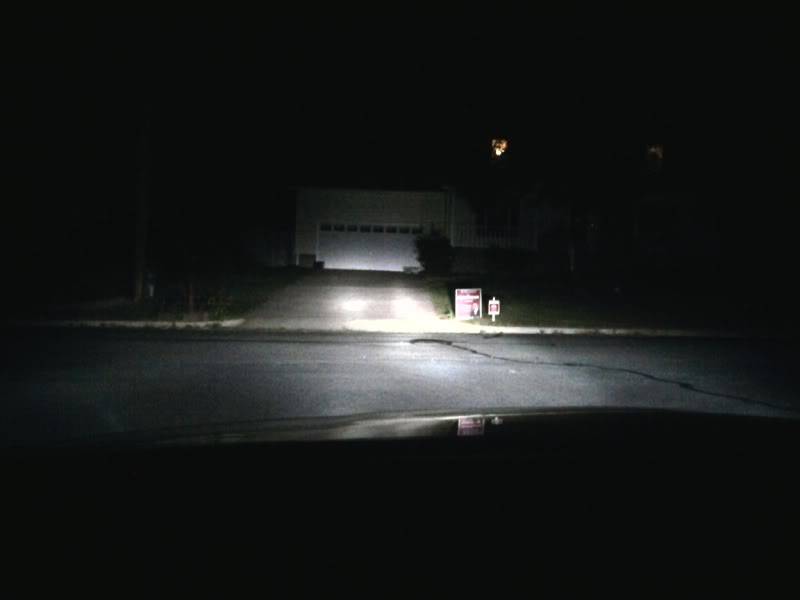

Dual 35 watt 6000K kits here and both run at the same time without any problems. I only need the lows but both do work without flicker. Latest phone pic taken about a week ago. Housings are one year old and rarely ever used at night. Phone pic sucks. It wasn't set for night shots. Anyway, don't see the need for a 55 watt kit. The housings don't need any additional heat for something that isn't really that much brighter.

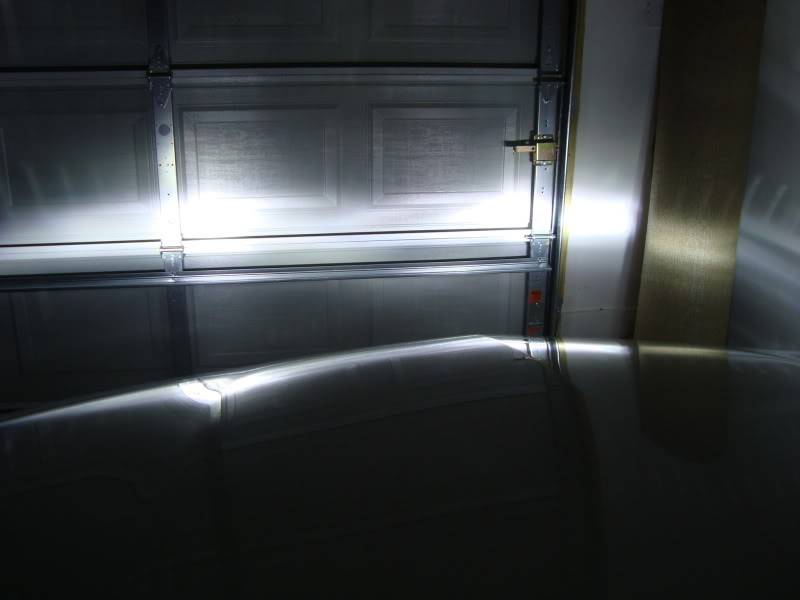

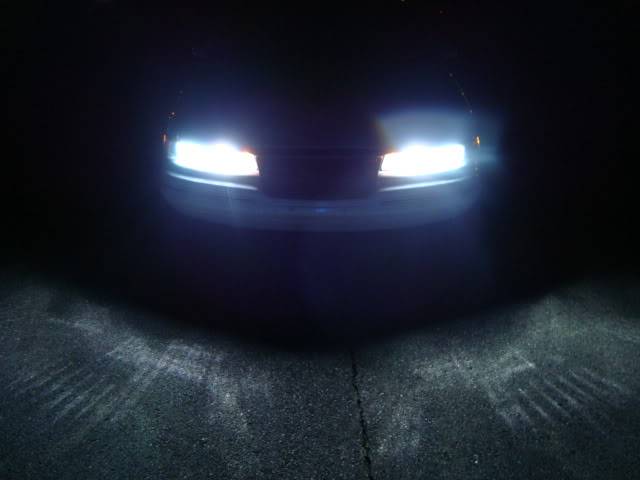

5K should be whiter than mine but then again, that is a phone pic. I really don't see a lot of blue in them though. I have had 8K before and there was some blue and I also have had 10K and they really had blue in those. I also have 12K and they look plain gay lol. They were purple. Pic of those below with digital camera.
These were with 8K or 10K lows and 6K highs.
These are both 6K high and lows inside the garage.
