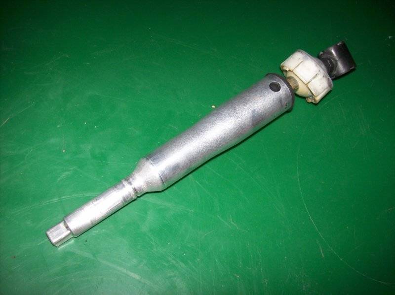

I have removed my shift knob a few times. You need to push down and turn it 1/4 turn, either way. Then it will pull up. I also have looked for shift knobs from BMW's. The setup is different. Look at the pic I have posted. The top of the shifter kind of looks like a 3/8 socket. The shift knob snaps down over it so putting it back on you just need to press it on and turn in place.

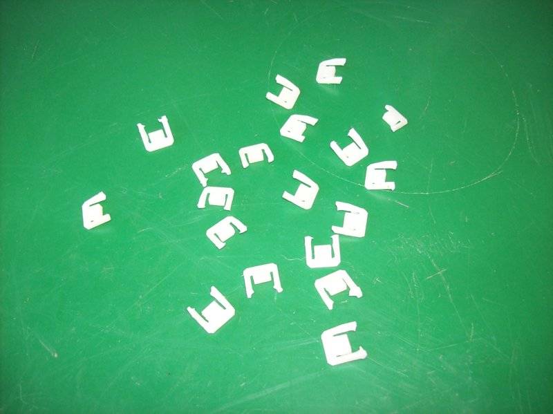

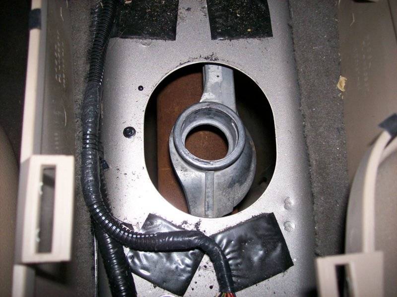

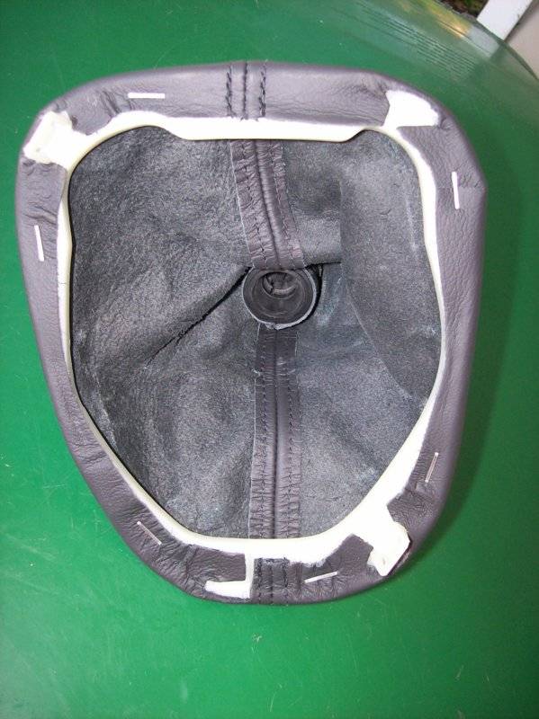

Couple of thoughts. When I first got my LS the clips that hold the shift boot were broken. I had it replaced at the dealership about 5 times when the clips would break. I thought it was poor design, but after working on the shifter myself I discovered that my shifter was installed backwards at the factory. Should you ever take the shifter out you can see a slight bend in it to one side. The bend needs to point to the passenger side or the shifter will interfere with the plastic frame of the shift boot and break the clips. I finally just drilled holes where the clips were and used zip ties to hold the boot down.

BTW, the last picture is all the broken clips I found in the console from all the broken shift boot replacements.
