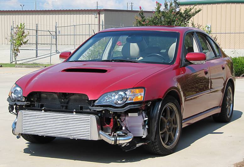

My old 400+ whp AWD family sleeper (yes, the bumper cover went back on after pics):
