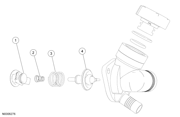

joegr Dedicated LVC Member Joined Dec 10, 2005 Messages 21,568 Reaction score 2,364 Location Gulfport May 2, 2019 #2 Neither, I suspect. You really want the Motorcraft one, and probably the plastic parts around it. 2W9Z-8575-AB, should be about $15 (Is parts 1 to 4 below.)
R rgorke Dedicated LVC Member Joined Aug 5, 2017 Messages 632 Reaction score 100 Location Camarillo, CA May 2, 2019 #3 They are both Motorcraft and I think you answered my question. MOTORCRAFT RT1163 {#2W938575AB, 2W9Z8575AB} 190 Degree Thermostat Info Bypass; w/ 37mm MOTORCRAFT RT1154 {#96JV8575CB, XW4Z8575CA} 190 Degree Thermostat Info Bypass; w/ 54mm
