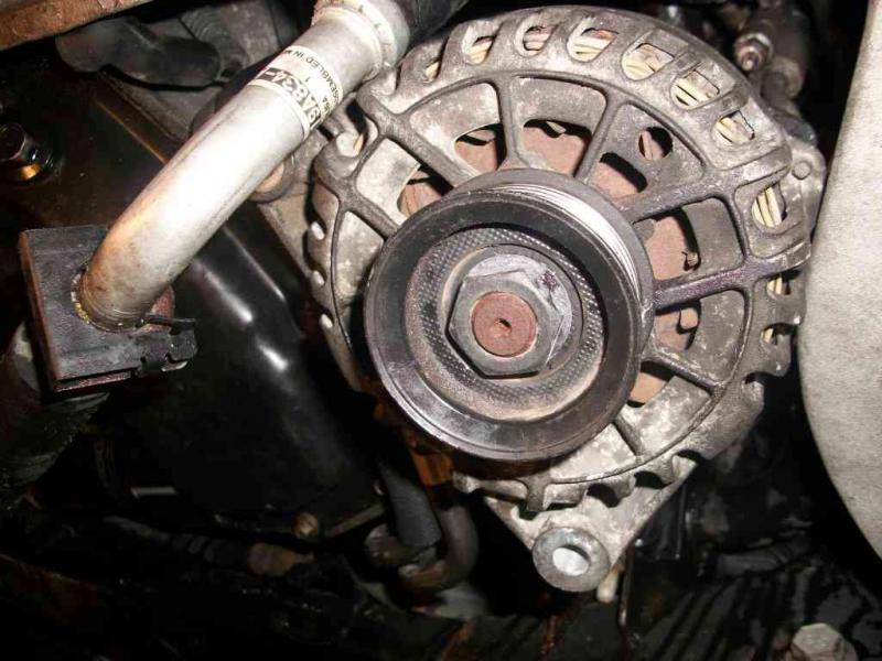

Making progress, have the alternator loose from the top mount.
Now onto the hard part figuring out how to remove the old alternator and slip the new one in.
Old I know this post is old butt if you ever have to do this job again remove your lower control arms that will shave about 3 to 4 hours off the complete job plenty of room without that in the way.

You didn't mention that it's necessary to position your face directly below the loose alternator so as to be able to drop it on your nose when it finally comes free.
KS
You're welcome.
Although, to be fair, someone else took this picture and posted it years ago. I completely forget who did it though.
