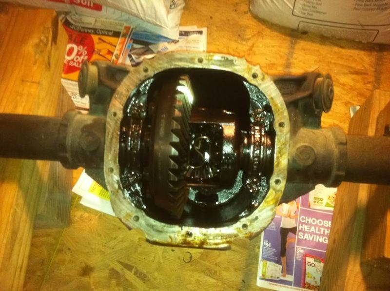

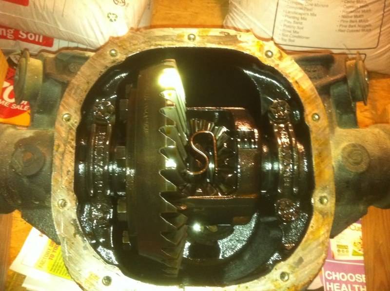

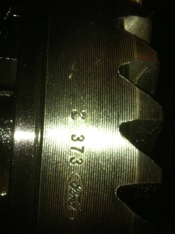

I just picked up a set of 3.73 gears with Trak Lok $125.00. I got the whole a le assembly. Excellent price.
just another add to the to do list. But great deal, got to grab them while you can. What did the axle come out of, T-Bird, Mustang?
Sweet! Good deal, good enough to warrent getting a rebuild kit for the TL. You can add an extra clutch to each side easy enough and the thing will last longer and have more bite.
Another cheap upgrade is to get a F-150 "S" spring. Its alittle harder to install but adds more grip to the clutches. I did this plus the newer Kevlar Ford clutch rebuild kit.
