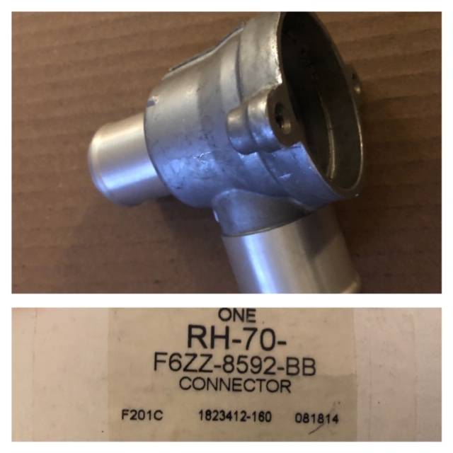

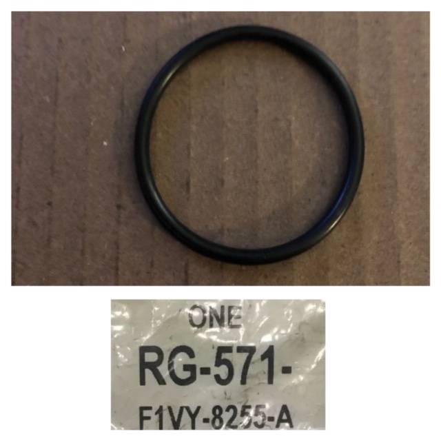

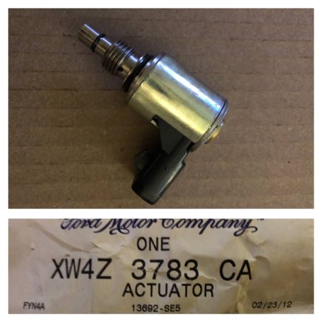

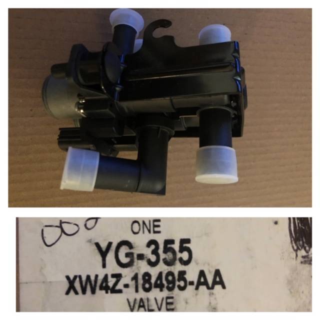

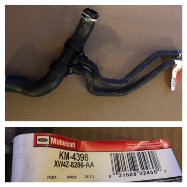

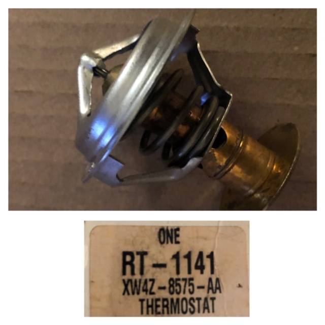

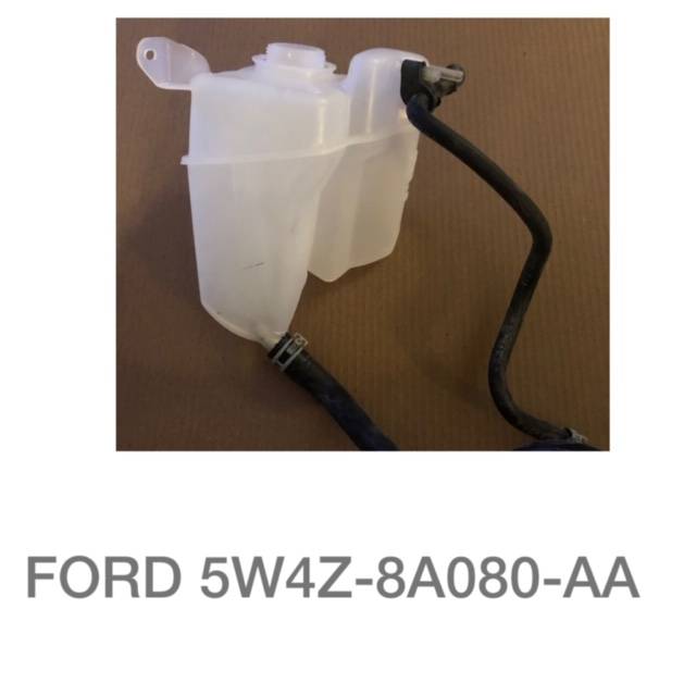

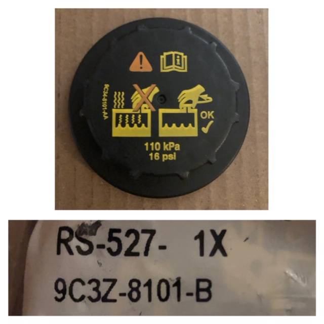

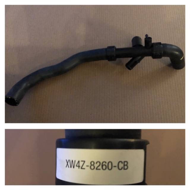

Well, sorry it's taken so long but all went well with replacing most of my cooling parts (2002 LSE V6 Manual). Here are some pictures of the parts I replaced, all are Motorcraft and I was able to buy almost all of them as new old stock on Ebay for the most part, at far under list rice. It did take a while to acquire everything but was worth the savings.
