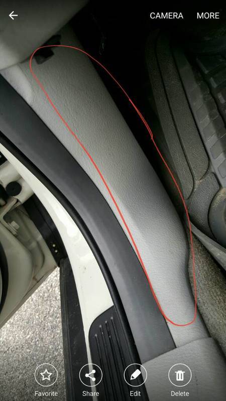

I'm pretty sure it trickles out between the pinch welds under the rocker panels. If you pull the plastic trim piece off by the footwell you can see the drain tube through the little holes.
Take this piece off and you can see the drain tube through the holes.
