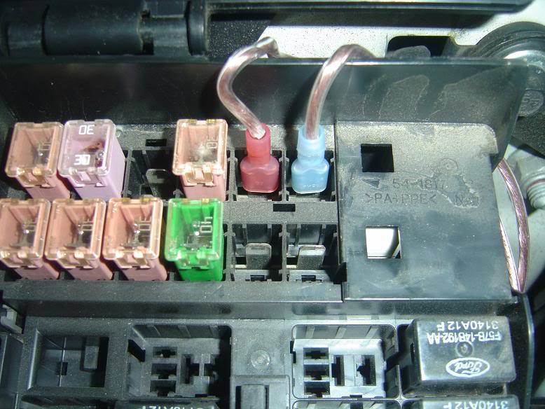

i got a relay harness with my kit.. were can i connect the positive cable from the harness since the battery is in the trunk?
fuse box in the engine bay
thanks for the help..how can you tell which one is positive and negative? I have no owners manual
Both positive. I used one for the left relay and one for the right relay. Negative goes to ground. Find somewhere to ground it, there are screws all over in there that are grounded. Also, in my gen2 there is a screw where a wire is grounded behind the driver side headlight, I just unscrewed it and put the ground wire in there aswell.
you really got 25k hid or did you mean 5k and accidently press a 2 before?
the place i got it from said it was 5k..i didnt notice i put 25..so i can put the positive terminal from the relay harness in any of the fuse box locations?
oh ok...Yeah, power runs through the fuse box, both wires shown there are the positive wires going to the relays. Also, just a heads up because it happens a lot. If you're hids dont turn on, or only one turns on, try flipping the connections because some of the harneses are flipped. Reg bulbs didn't require + and - side so they were just thrown on there but hids do have their right way of being connected
