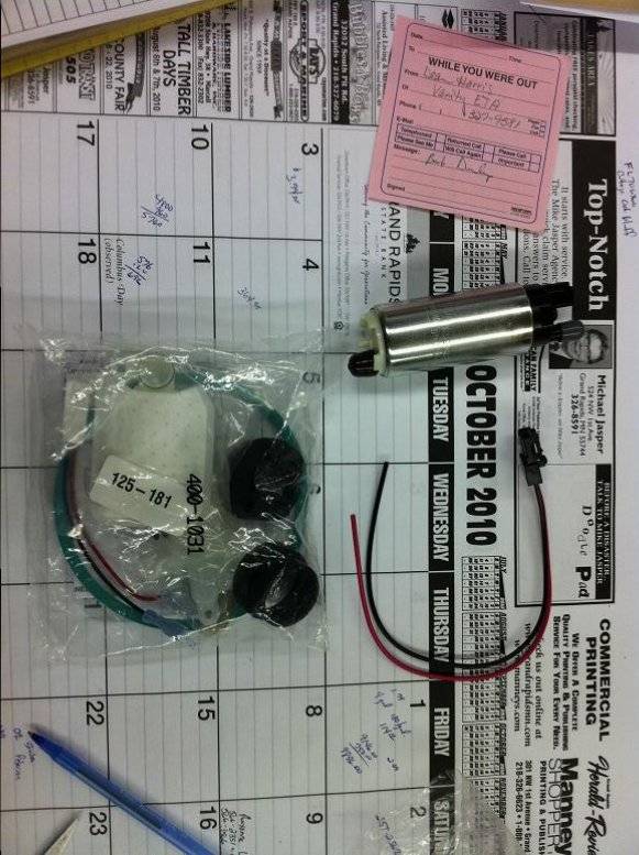

255lph walbro found!
This will fit in the gen 1 v8. I did not check other engines or generations.

Fedex just brought a package to me. The Walbro pump is a GSS342. Guess what I get to do after work ? :D

So the 255 does take some modification. It's wider and taller than the stock pump. I had to modify the lid, and take off the upper gasket on the pump itself. Still won't start. Wondering if I should've wired red to black and black to red. Kk told me that's how the gen 2 marks are. I just don't want to mess with the retaining ring again tonight. So I'm waiting until tomorrow to retry.
Fitment issues (not being able to use the sock for one, IIRC). This was supposed to be a direct fitment, although some modification to the housing was made.
Problem still not solved. Turned the key to on position, and now get 45psi. But still no start. Going to check if the injectors are getting power tonight after work.
Injectors getting power. Now have to check spark. SO glad I have a second vehicle.
It was weak, and needed to be replaced anyways.
I'm actually thinking (actually, KK had mentioned) that it could be the crank sensor. All the symptoms point to it. And it's a relatively easy and cheap replacement.
