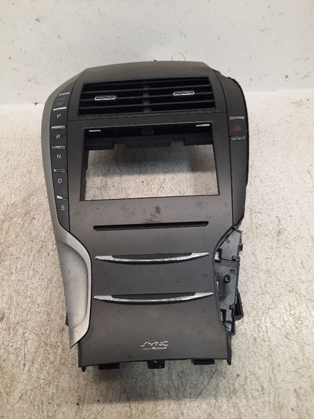

Here's what the thing looks like. But this one has only one switch on the right hand side. Mine has 3. Those 2 chrome lines are the radio vol and fan controls.
Yeah that pic is from a boneyard. But it wont be easy cause there are half dozen different ones. :(
I might be able to just get the module on the back side. I think FCIM.

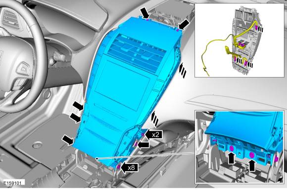

Here's litle diag from ford service CD. Upper rt hand shows backside with a couple of modules.
BUT even if i get the thing, i need to program it. Scan tool. Ugh. Hope I dont need to go to a dealer.
