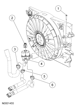

1. No. The LS has no air temperature blend door.
2. No. You DCCV has failed. That's under the hood at the right side of the radiator (right as though you were seated in the car). Item 4 below. AKA heater control valve.
Do not go aftermarket on this part. Aftermarket DCCVs usually only work for a few months at best.
Note that when you refill the coolant, it is very important that you follow the procedure below to the letter. Also note that it works best if the front of the car is pointed down hill. It won't work if the front is pointed up hill (the way that most cars are done).

Yes, that should be it.
